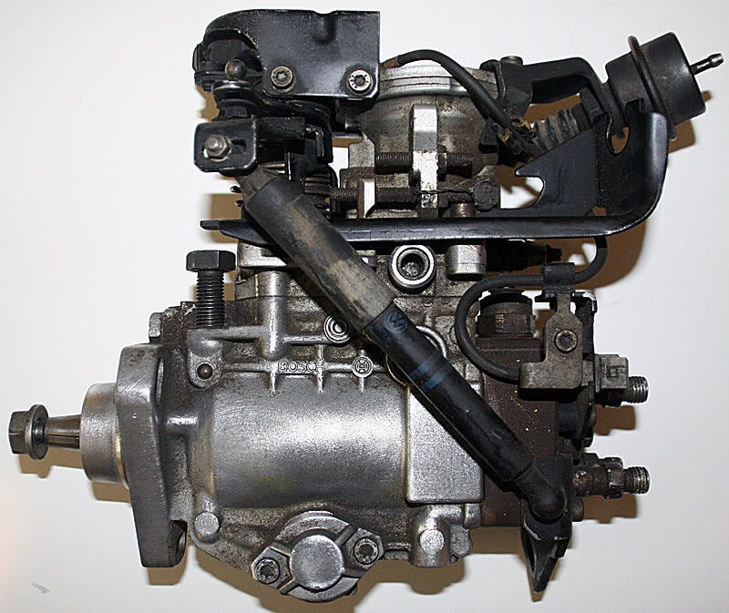

theres usually a damper there, that doesn't look original, almost like someones bodged it? The usual job is to remove them as they only act to slow the return of the throttle plate (if thats what its called?)
similar to this (same bosch pump ignore the VW badges!)
Stu

Re: Synergie loose spring in engine bay
Post by GiveMeABreak »
Couldn't believe I was actually seeing a shock absorber on your pick - those VWs must have a really bad vibration issue then! :-D But as you can see from the service docs for the 1.9D Synergie, there isn't any sign of a damper shown anywhere - I also looked at all the other parts diagrams, but nothing to indicate one of these IIRC.
Post by ken newbold »
My 806 and the Ulysse did have one at some time or another, but longs since gone, just the ball now where they used to fit. I'm pretty sure my spare engine that came out of a Ulysse stil has one fitted.

Gibbo2286 wrote:I'd guess that the original return spring (coiled under the lever) has failed and the one in question has been added as a substitute.
The thing is, it isn't a return. many cars have them removed! it simply damps the decelleration
