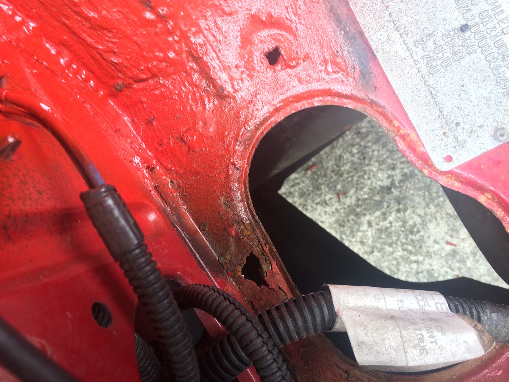

Hello all,
While I was messing around with my alternator today, I noticed this. I've only just got the car (new to french cars as a whole) and its really solid everywhere else and has done 60K miles only. I'm keen to keep it as my everyday car as the interior etc is in very good condition, engine bay is very clean etc and I haven't seen another ZX anywhere near as good in the time I have been looking.
Is this treatable? (It's drivers side inner wing RHD, I have no PAS so no tank there) Could I rust treat it and address at MOT time (March 2017) with a weld, or is this going to eventually kill my car? It's had a couple of plates welded in nearby but they have held for about 4 years now (that's what I was told by PO). However if I need to act now I can look at sorting it.
I'm not handy with a welder etc myself and I know little about bodywork really.

Well I don't think it's going to deteriorate further between now and when the MoT is due, and to be honest it's not suddenly rotted to that degree in under 4 months either so unless there was an advisory on the previous MoT about it, it *may* be in an area not "testable".
While I don't believe there will be excessive deterioration if you were to leave as-is until next year, if it were my car and I planned on keeping it then I'd get it cleaned back to solid metal (may make a bigger hole than you expect if done properly!) and plated up while the weather is (supposedly) on our side.
Not much point IMO applying any sort of rust treatment to that degree of corrosion, new metal either now or later is the only thing that'll stop it :)

I agree with the above, too late for rust treatment and a bad place for filler. That needs a patch welding in, preferably a good piece cut out of another zx.
Is there more rust under the sills or wheelarch? If the rest of the bodies good I think it'd be worth getting repaired. If the rest of the body needs work maybe consider other options before it becomes a nightmare.

Yes it's the only place, the sill and arches are totally rust free on both sides. It's had a couple of plates along the inner wing nearby. A friend reckoned it might have had a small bump there but I don't think it has, the wing looks original (paint matches the bonnet also) and it's totally HPI clear
I think a plate would be fine as long as it's a decent job
Other option is sell it and get another or a TD but I don't really want to as this is such a nice example and I love how economical it is. I don't think a TD could match it

ZXs (and 306s) rot in the inner front wings for fun, all pretty normal. Easily sortable if you're not too bothered what it looks like.

Definitely needs cutting back and a plate welded in. IMO it's best to cut out the rot before it sets in

Plate sounds like the plan then. This car is my like day to day car so not too bothered about looks just functionality. I plan on keeping it till its scrap really.
