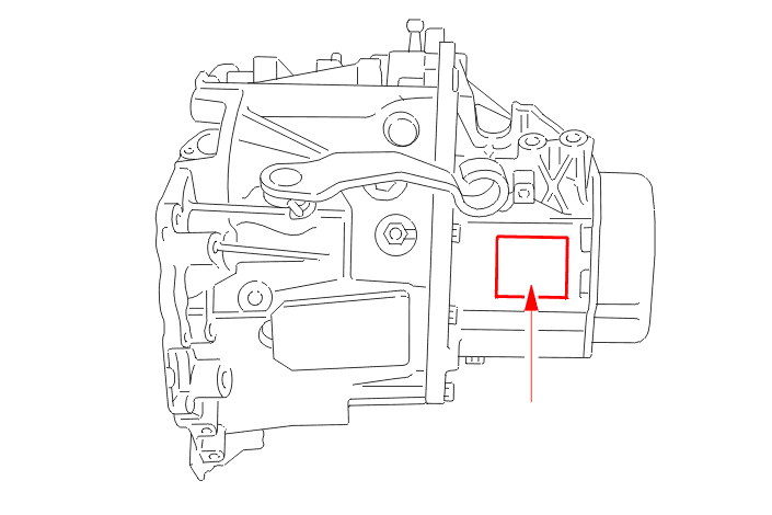

Hi All
Can anyone tell me where the code is stamped on a 1997 806 gearbox please.

Re: 806 gearbox
You have the BE3/5 transmission (possibly BE4 but it should be the same) On the front, might have to remove a few bits to see it.Barry1 wrote:Hi All
