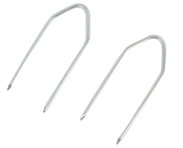

So, in simple english ... you want to pull the unit out? Why didn't you says so ... you need something like this:
Or 4 thin screwdrivers, to insert into the holes to release the side hooks

Thanks for the reply as I suspected wire coat hanger job. Got some I made earlier (Blue Peter).
