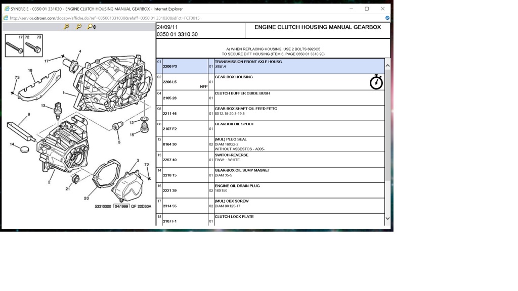

This is the filler plug, which is on the end casing, at around 4o'clock:
12221 30
GEAR-BOX FILLER CAP
DIAM 14X100
However, if you've taken something off the top of the box, then that is the breather:
2268 14
RP 2268 30
GEAR-BOX BREATHER
Prices
0000222130 FILLER CAP 3.91 GBP 4.69 GBP 4.69 GBP
0000226830 GR-BOX BREATHER 3.49 GBP 4.19 GBP 4.19 GBP

The gearbox hasn't shown signs of trouble so I can only assume that where I put the oil in definitely leads to the gearbox. It's still a bit of a mystery though as that diagram doesn't look like my gearbox.

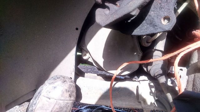

I don't think that has worked, trying to do this on my phone. I've had to take the o/s driveshaft off to replace both boots while I'm doing both discs, pads and o/s wheel bearing. Like I say, the filler plug I found was on the front of the 'box and is pretty mangled. This one is on the side of the box (n/s of car) at about 8 'O' clock.
I'll give it a try and see what happens.
