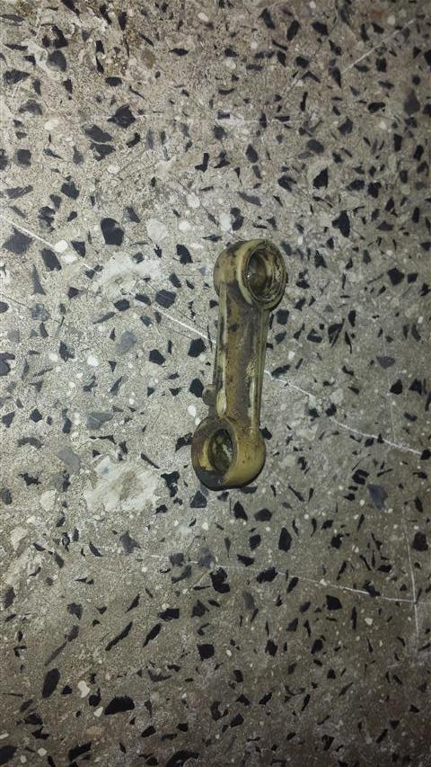

I believe the first photo is a tie-rod connector - is that so and where can a get them Please?*Image

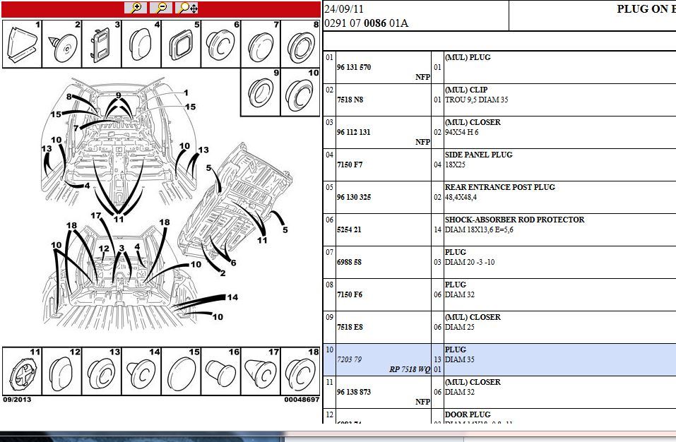

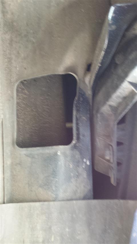

The second is a hole in the rear n/s wheel arch - what should be in there and where can I get one*

For the dog bone, try http://www.ebay.com/itm/Genuine-Rear-He ... 1167722566
The rectangular hole is I think always open, nothing missing there.

I've now ordered a couple of the height corrector rods from eBay.
However they show nothing for a Rear Entrance Post Plug (as so described on the parts list - slightly unfortunate choice of description I feel)
So I'll beaver away on google and see what I can come up with!
Alasdair - thank you for that kind thought - something you can be sure I'll bear in what little mind I've got left.

The hole you have shown in your photo is not the rear entrance post (which is an oval hole, not square), I think the hole you have shown is at the top of the wheel arch and has no plug.

The hole is certainly at the top of the wheel arch and is only on the nearside.
Am I correct in saying that the REPP is on both sides?

The REAR END plug :) (I am such a child) is obtained only from a main dealer, I have not seen them on ebay. The sill can/could also be sealed with a mastic barrier.
I do not think it is that which you are after however........
