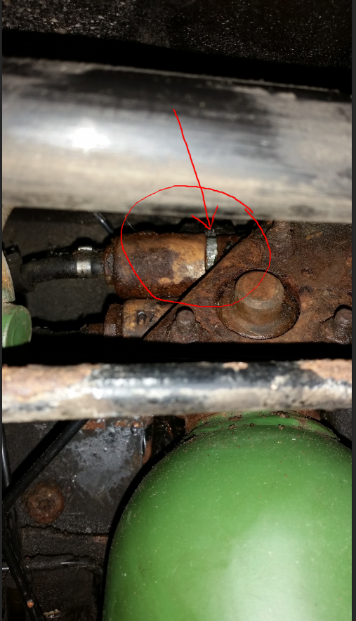

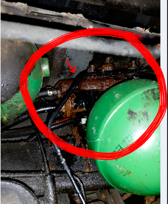

From what i've found of faults its the leak from the rear and a leaky radiator in the front. The brake discs could use a quick turn in the mill . will measure how thick they are first.

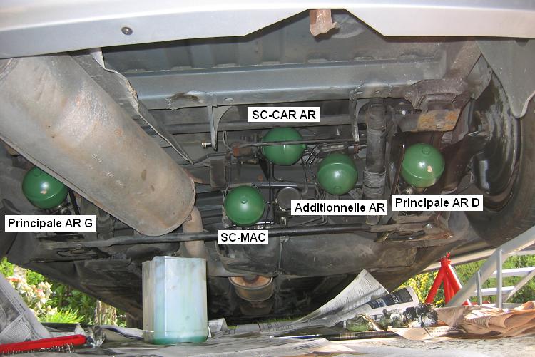

I will link a picture to the leaky part in question as i do not know what it is called .
the "collector" with return feeds and pressure feeds has what looks to me to be a crack where it pushed out the connection for the return feed .
the oil bleeds from what appears to be an inset being pushed out. It is not that much of a bleed since its a return lead.
Got no clue thou what this is called :)
Borrowed a picture so everyone understands where this sphere is located :

BTW: the part above is located at the rear right just in front of the Activa Ram Bar

The leaking component is the Hydractive electrovalve and it is now a common problem. It is leaking die to dissimilar metal corrosion; the body of the valve is made of light alloy and it sits on a steel block..
Spares are now getting increasingly rare but the bad valves are fixable with a bit of lathe work...
Have a look at this thread for full details...
http://www.frenchcarforum.co.uk/forum/v ... hp?t=41919

CitroJim wrote: It is leaking die to dissimilar metal corrosion; the body of the valve is made of light alloy and it sits on a steel block..
It is leaking because it keeps damp in those areas (by dust and mud etc).....only then will Aluminium corrode. WAX the area
(Jim, I know I am being pedantic but Al/steel is passive until you add water, only then do we have problems. Painting is worse as it traps the water and concentrates the rot. Wax protection or anodising, as you know I use battery protection wax spray for that, it is cleaner to wipe off than dinatrol :)

Stickyfinger wrote: It is leaking because it keeps damp in those areas (by dust and mud etc).....only then will Aluminium corrode. WAX the area
I never paint the joint areas if its a large item )
Absolutely agreed :D
