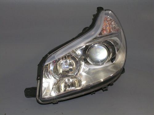

vborovic
- Locked user account
- Posts: 1750
- Joined: 31 Oct 2013, 17:07
- x 40
Re: C5 Headlight issue
So, you have headlight washers but regular halogen headlamps then? ... that's what wheeler was asking about ...
Regular (halogen):
Xenon:
Regular (halogen):
Xenon:
