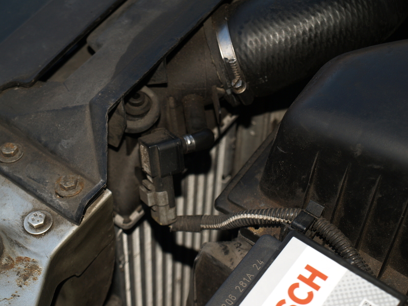

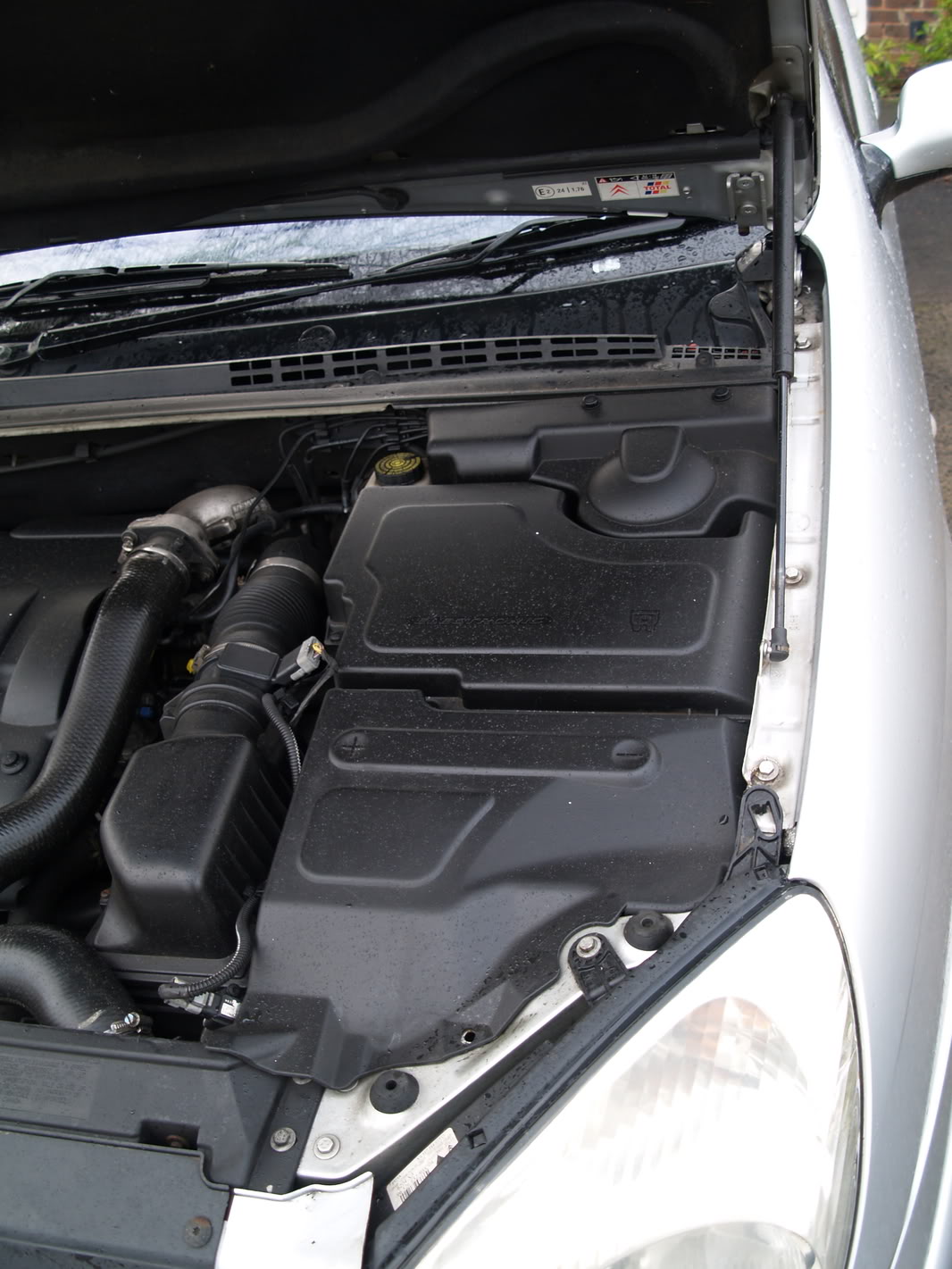

Managed to get some images up from google. That sensor sits limp in my battery tray. I seen it in there and didn't know what it was. Will need to investigate.

Where it should be.

This looks more like mine. http://www.406oc.co.uk/viewtopic.php?f= ... 4&start=30
Does the tiny air spigot hose connect to the sensor then? I see no male spigot on those sensor pics? Need to check tomorrow. The sensor has the male and female plug connected IIRC, just not mounted on bracket.
