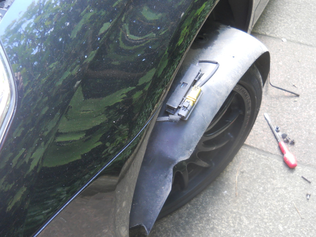

On my C4 VTS (which I think is similar)I no longer have the wheel sensors as I have aftermarket wheels. I have toyed with replacing them, but was unsure if they'd fit in the new wheels. I am not sure if the C5 is the same as the C4 in that mine has sensors clipped to each wheel arch liner and wired into the loom. (I discovered these when I had to replace the front liners due to a meeting with a small furry animal) I imagine this part would not be fitted to a lower spec model and would be very expensive to add. Have you checked if yours needs these?

Here is a pic of it on the C4, it clips to a moulded lug on the arch liner
wheeler
Posts: 7938
Joined: 21 Sep 2002, 19:07
x 1061
Re: C5 Mk1 TPMS upgrade
Unread post by wheeler »
Those recievers on the c4 are fitted to the mk 2 c5 but not the mk1. Different system.
