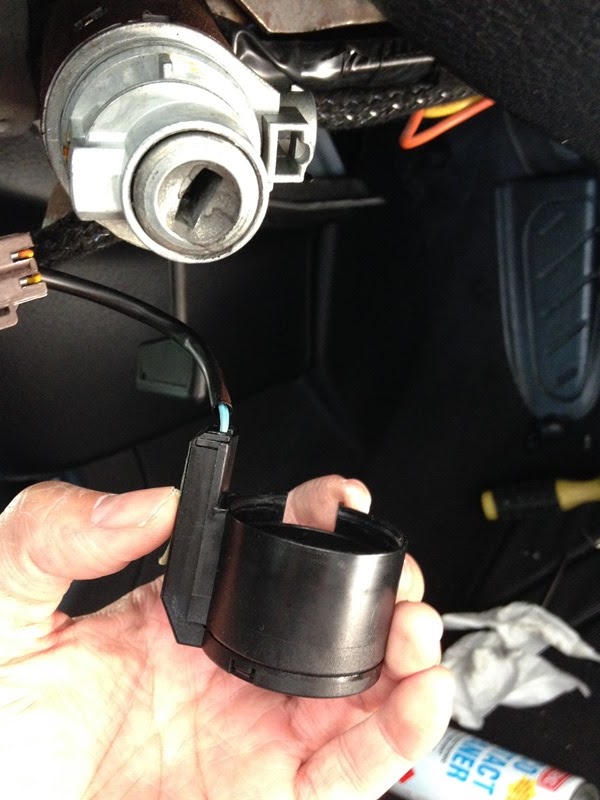

Dear all,
I cleaned the connector of the immobilizer receiver at the key holder.
I think now the problem is removed.
LOVE is All AROUND.

Thank you Jim,,
Happy chrismas.
Here is an imobilizer receiver.
