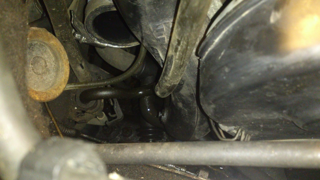

here's a view of the area in question. Turbo pipe removed for clarity.
So if you're getting diesel smell after switching off then check here.

Re: Xantia 1.9TD diesel smell
Much neater job than mine too
No worries man, it boggled me for days and your symptoms were exactly the same so it was worth a shout. Seems this pipes more and more likely to split nowadays

Haha that was a 'before' picture! It's the neatness of the 1993 assembly line at Rennes-la-Janais, But the repaired pipe is now routed further outwards (towards the sphere area) and routed down to the connection with the diesel supply pipe.
A previous owner fitted a turbo boost gauge - works well and lots of fun but I noticed the feed pipe for the gauge (comes off the bosted pipe to the fuel pump diaphragm UFO) was actually a reall long pipe and I reckoned this would cause the overall inlet volume to be fairly increased and would affect the boost curve so I shortened the pipe and lo, it's actually tightened up the performance.
Anyway, 24 h after the new fuel pipe and no smell of diesel so success!
