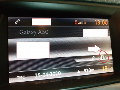

Re: Bluetooth Paired But No Sound Coming Out Of The Speakers.
How can I turn on speakers again? There are stopped working by itself. On display X sign.
Thanks!
I press mute button but nothing happend.
When I am making a call my radio gets a little bit decrease volume but I can not hear sound of phone.
I will try different phone. My is Android 10.
I reset all Bluetooth device. Now is working OK.
It was my phone problem.
Thanks!
