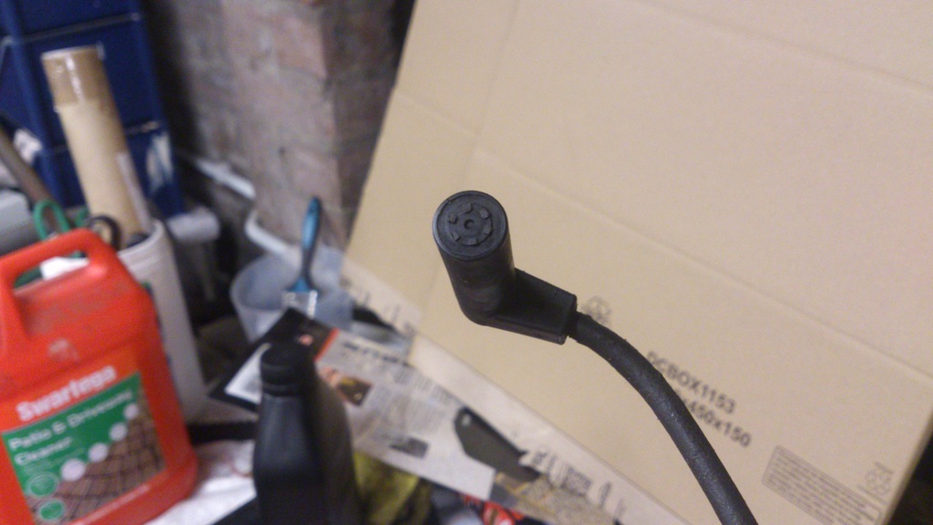

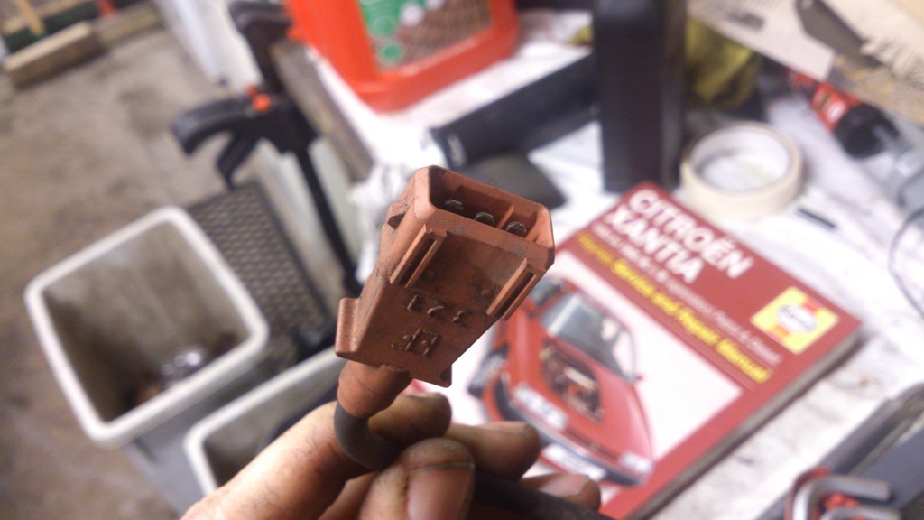

Hi all the tacho on my early mk1 sinker TD is inoperable - never a flicker from the needle. I know it's a common failure on the series one as my previous mk1 TD Charlie Brown had the same issue. I see no mention of the tacho in the Haynes book but it's ready to remove the sender so it's out for looks. It measures no resistance or continuity between any of the 3 pins. With no spec available not sure what to expect but would have thought there would be signal to- from and earth. Anyway there's no sign of a part number on it either.
Can anyone help with id for this part? Pictures to follow later. Or I'd anyone has spare sender available if be keen!

It's the crank/flywheel sensor isn't it? If theres no readings from it then it'll be dead, as the only other issue is the one mine has where it dies periodically due to being fitting wonky/dodgy wiring!
I'll get citroens part number on it for you
Edit: 5918 94, listed as TDC sensor but more commonly known as crank sensor. Seems to be pretty common across the board

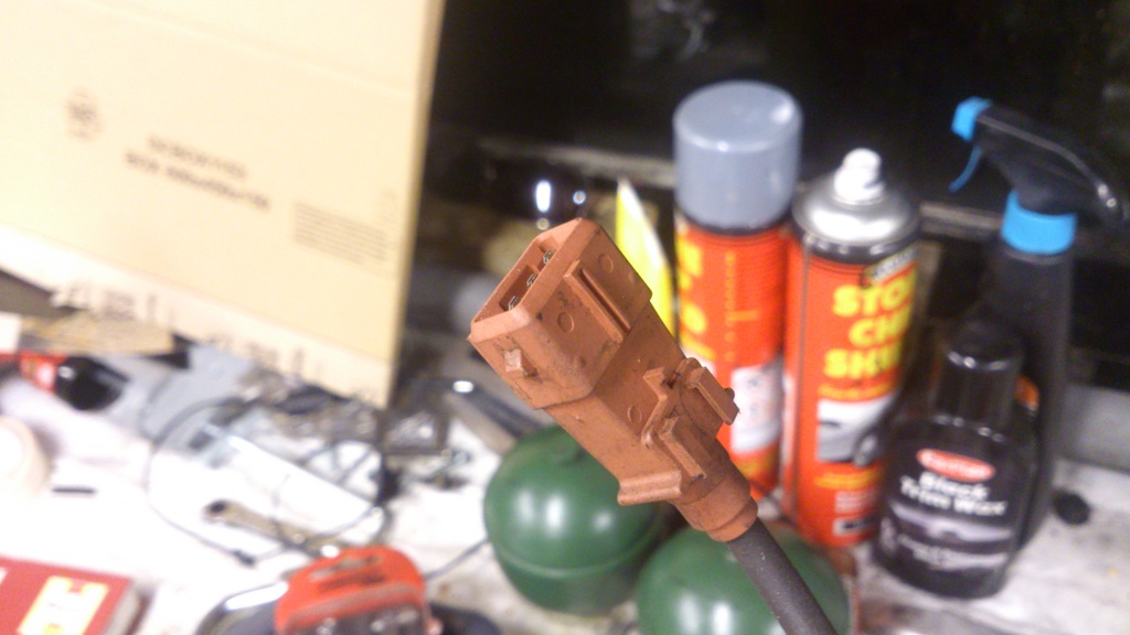

Don't they have different coloured plugs too...grey or brown...?

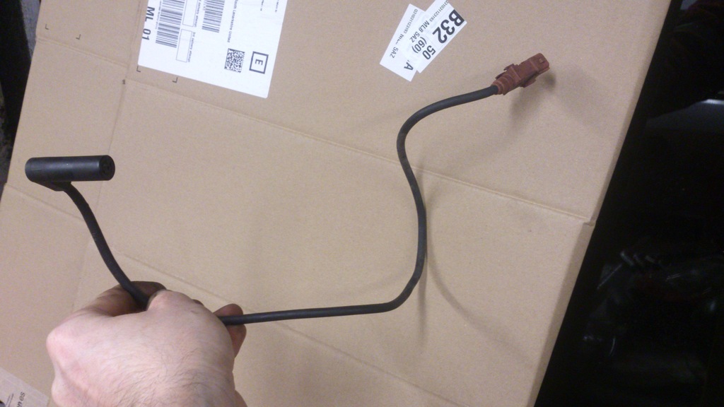

Yes, this one has a brown plug - looks like this:
and now I come to think of it I think it is the same as the TDC sensor from my previous XM SEi Turbo.. and I replaced that sensor .. but did I keep the removed one ? I do not recall..
