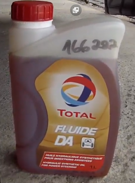

Omg guys it's I'm so happy to finally find what I tried to figured it out for 3 days... I get a Citroen C4 from 2005 and I just change my power steering pump.. but the things is I didn't know what kind of liquid I suppose to use for.. so I used the fluid DA and I saw a lot of people says Total Lds is the one I have to use for my car.. but the things is I already topped up with the DA.. I now for 3 days after been on how many french websites. Try to know if it dangerous to keep this one... I finally got my answer in a UK website... I'm so happy to finally know Fluid DA=LDS thx guys I owe you one
x 6945
Re: DA vs LDS
They are the same thing, they just changes the name from LDS to DA.

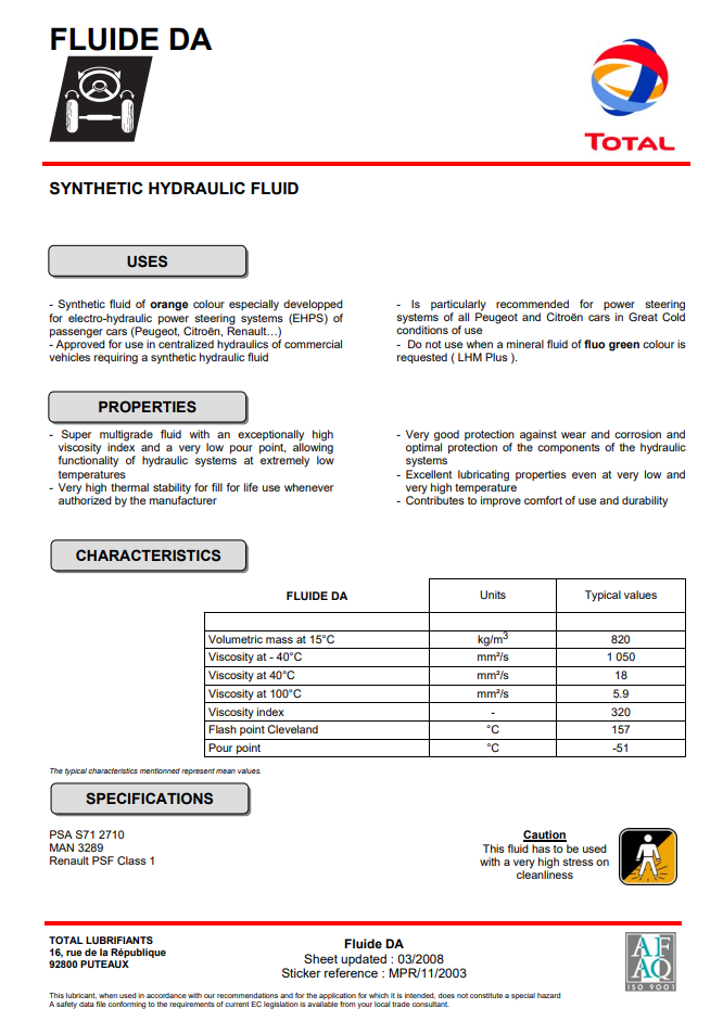

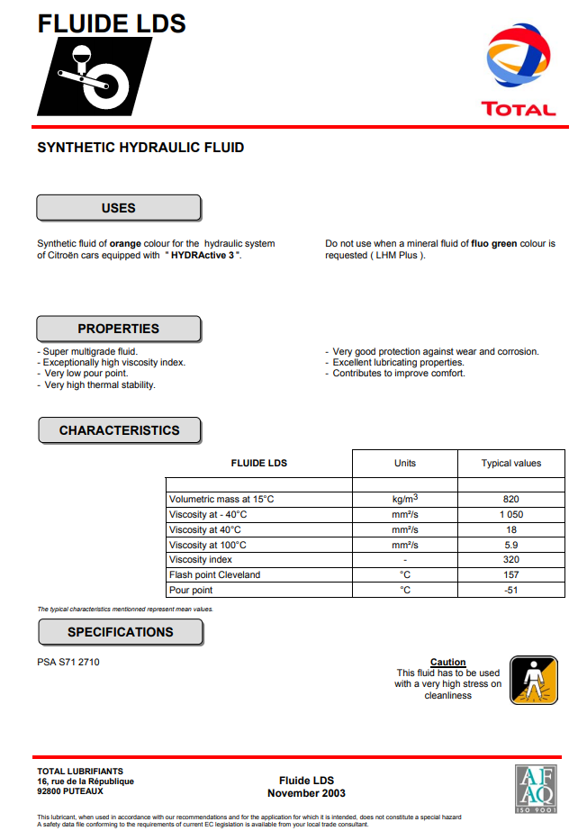

Just for clarification on this subject for all the previous posters as to the difference - none! These are the specification sheets. Total Fluide LDS has been renamed Total Fluide DA from about 2008. Colour is the same Steve. PSA specification is the same for both fluids: PSA S71 2710
Specification Sheets - identical:
(Click images to Zoom)
