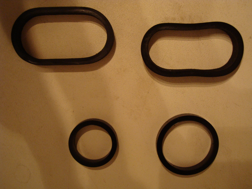

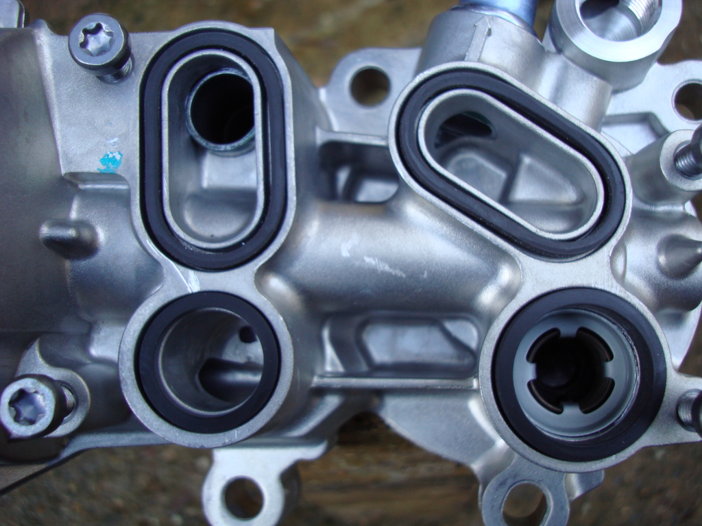

Hi,Have now changed oil cooler on my 3008 HDI 150, it was not easy as you have to drop the Air conditioning compressor out of way for access and its a 2 man job to lock the Aux belt tensioner. The good news is that after 500 miles my coolant still looks clean of oil contamination. I was wrong about the gasket being a flat face flange joint, they are round and oval square section seals luckily still in good condition. Please can anyone identify a part number or supplier of these from the pictures attached as I may have to replace them next time an are not listed in Peugeot parts.
Thanks for any information.

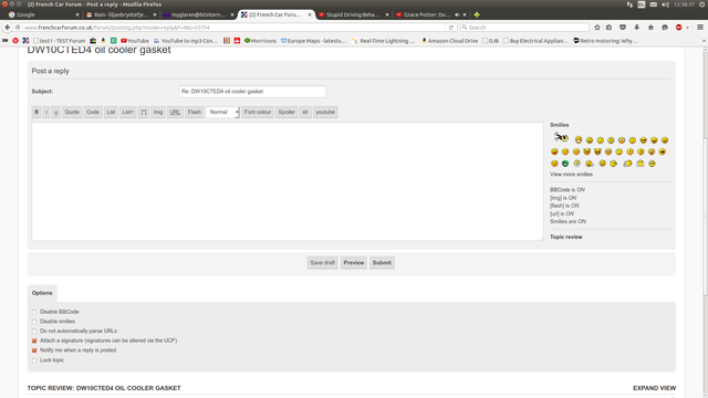

There is a checkbox in the Options list on the lower right of the reply box:

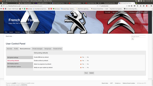

Or you can enable it in your profile - Click the dropdown arrow on your username top right above the banner, go to User Control Panel, Board Preferences, Edit Posting Preferences.
As these are generally enabled by default I presumed you had disabled them yourself.
Shout up if any problems - I enabled the images in your post above but the first one does have broken links in it. Fixable but not worth it now.
Click the screenshot images above - will take you to PhotoBucket, where a couple more clicks will give a full size image, hard to see otherwise.

As my son would say, cool. Thanks for the information and can I add for other newbies that you have to select full editor & preview bellow the quick reply window to get the full reply box shown above.

Even better, the "Post Reply" button to the lower left - although I generally use the quick reply box and wish I hadn't.
