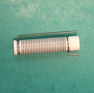

It'd only be on when the stalk was pulled. You're right though, I can pull the stalk for quite some time.
What does this heat exchanger look like? I can 3d print one with a sintered bronze filament.
