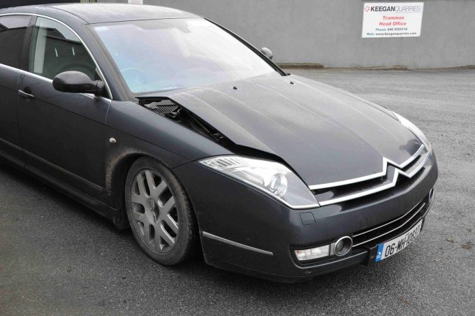

Even on the C6..which means some X7's will go soon
That above is part of a range, a cleaner and a "protective spray"..as it is used for boats, and has good reviews, just wondered. ??
http://www.rib-shop.com/rib-conditioner/
