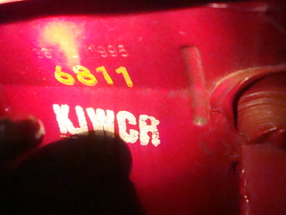

Hi Richard, the rp num is 6811 (I think) and the VIN is VF7**************[VIN obfuscated, can be read by forum staff]

That picture is the RP number - although service.citroen thinks it was built the day before :-D
