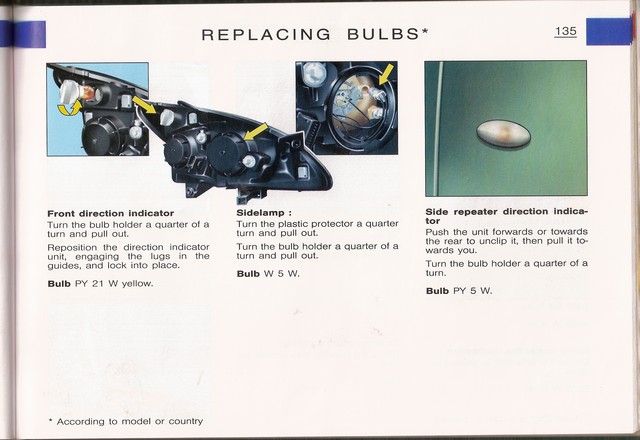

I think you are referring to the sidelight bulb.
Click that for larger image.
Rear view.
PhotoBucket being difficult about posting a thumbnail of this - hope this image is satisfactory.
It actually works as a thumbnail and in PhotoBucket you can enlarge it.

Thats the one the sidelight...
am a complete car novice.
Whats the bulb called please. i.e what do i look for from eurocar parts etc? (Be buggered if am going to halfords)

The bulb's a 12 volt 5 watt capless and you can get a box of ten for just over a quid http://www.ebay.co.uk/itm/10-PACK-501-S ... 3f3179f43a

501 bulb, dead easy to replace on the MKI. Take headlamp cover off rear of lamp unit by turning 90 degrees, pull sidelight bulb holder out and push fit the replacement bulb, push into sidelight hole and re-install headlamp cover. You can use LED bulbs for brighter sidelights but bear in mind they will only fit one way in the holder because they are polarity specific, standard 501 bulbs will work either way around.
