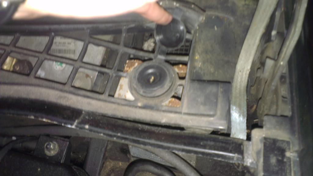

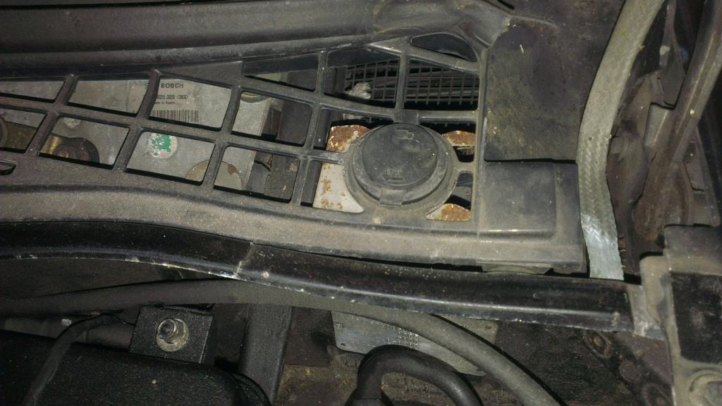

You can also turn the alarm off by opening the bonnet and turning the key switch in the skuttle panel. It's on the passenger side IIRC, has a plastic flap covering over the top of it.
Hang on...
Here;
Excuse the quality of the pics, it's dark out there now :lol:
That 'permanently' switches it off (until you turn the key switch back on again). Remote locking/deadlocking from the plip still works fine.
I'd recommend silicone spray for freeing up the locks. They're a pig on my Activa too (what comes from sitting around for years :evil: ) Most important thing if there's a chance the battery will go flat before you next want to unlock the car... Don't deadlock it! (Not that I've found that out the hard way, you understand...)

The key switch was deleted in later S1 models. My Activa lacks it..
Shame really as it was an excellent idea.
