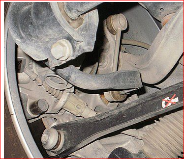

- Posts: 11849
- Joined: 28 Mar 2013, 21:05
- x 2004
Re: Anti-Roll Bar Bushes C5...09
dats the little @@@@@@r.......will get a close up tomorrow, but to me that looks quite standard...whut u rec ?
ps...not my car
osx
- Posts: 770
- Joined: 08 Jun 2013, 20:09
- x 15
The one at the top left? Doesn't look very special. Are the drop link ones ok? They seem to be the same colour
C5 X7 Exclusive 2.0 HDi Auto
- Posts: 11849
- x 2004
Yep that's the one....(it is not my car in the photo).....my bushes are getting damaged by the black plastic coating on the roll bar and thus is now in sharp bits under the bush....nice
As you say, it does not look that special, we shall see tomorrow when I get under my car.
drop links are fine
drop links are fine
