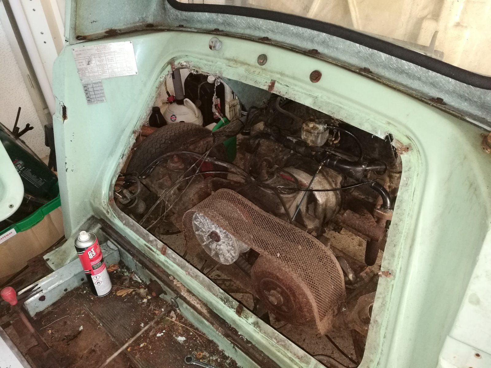

Also managed to get the cover off so can finally get into the transmission, so can get the drive belt (which is way too slack) adjusted properly.
Might actually get to drive it around the drive a bit tomorrow! Not really been able to do anything with it other than walking pace because there were no brakes!
Not many cars with a drive system that looks like this!

That's a meaty looking belt Zel :)

It is a bit overkill in the belt department I reckon, last time I came across one this size it was coupled to a 20hp 3-phase motor that ran the huge centrifugal blower for the grain drier at the farm we lived down the road from. The blower was a good 20' in diameter - the axle was well over head height, and the lower edge was well below floor level.
Have to admit that the noise that thing made during starting up used to make the hairs on the back of my neck stand on end...Along with every other hair when the star-delta contactor dropped back in as it got up to speed and you used to feel the (concrete!) floor jump...Shudder to think what the current draw during start up must have been...don't imagine the compressor on the refrigeration side of that (it was basically a giant dehumidifier) was exactly light on power use either...Only time I've ever seen a V8 configuration compressor in person.

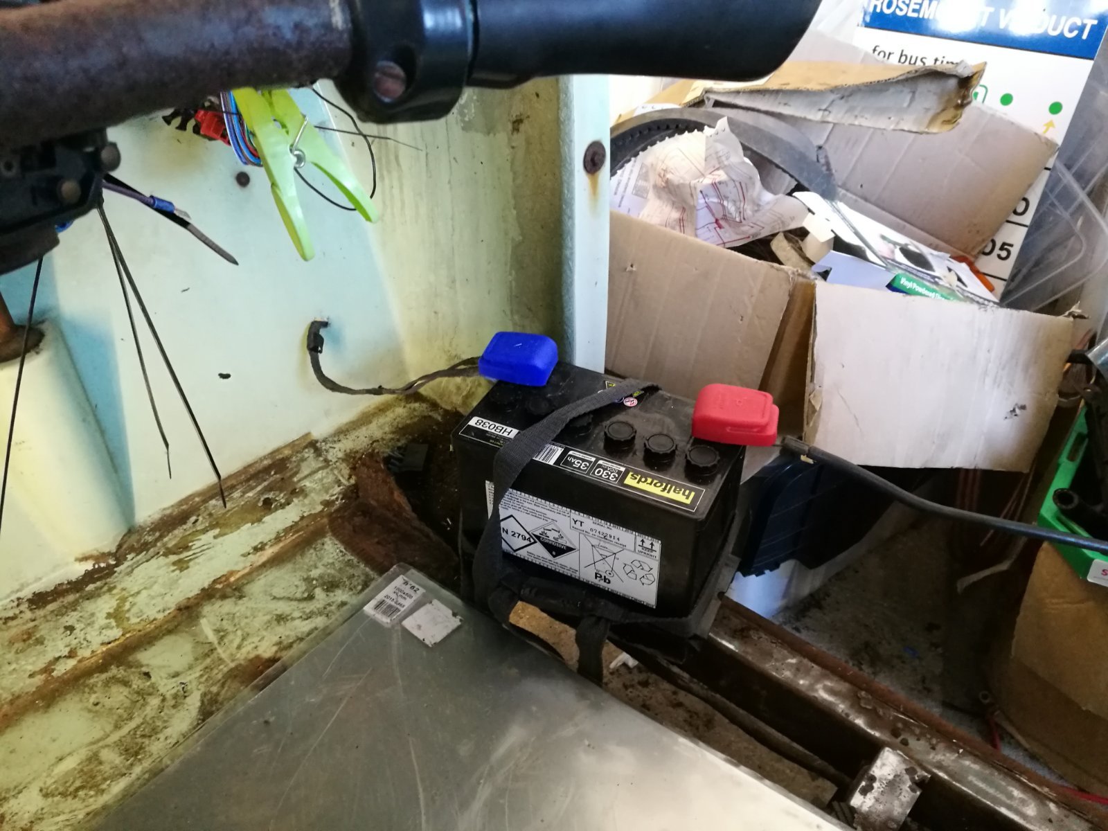

I then thought I'd have a look at adjusting the drive belt tension - have come to the conclusion that I'll try that again after I've attacked the front of the gearbox/chaincase with the pressure washer - it's just so coated in gunk at present that I can't even *see* the three mounting bolts I need to loosen first. I'd like to be able to see what I'm doing so I don't go and wind up loosening the wrong thing and dumping half the gearbox oil all over the drive as that would be highly annoying.
Annoyed at coming up against an issue there as well (albeit one that just needs me to dig the pressure washer out), I decided to do something that I knew would be easier - and stuck some quick release terminals on the battery.
Given that this battery is actually shared currently with the C5, it's useful to be able to get it in and out quickly. It will return to the correct location in due course as well.
Once it is back in the proper place a battery isolator switch will be installed as well - as I trust the electrics in this thing about as far as I can throw it and I'd rather not burn the house down.
