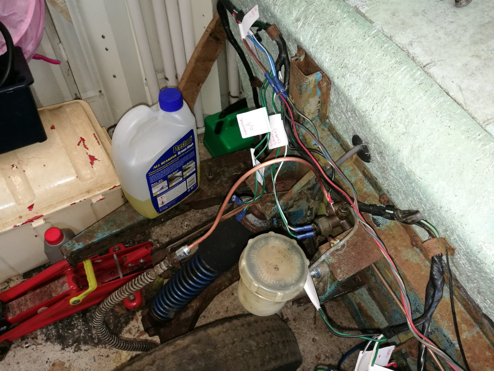

So had a spare hour this evening.
Was glad to find that not having used it probably in the best part of ten years that I still remembered how to properly make a flared pipe joint. Not sure if I've ever actually made one up for a brake pipe thinking about it...dozens for HVAC stuff though.
In an hour I'd made up the last couple of pipes I needed, had them fitted, and bled the system through.
Reckon there's still some air trapped in the master cylinder, so it's been left "with the pedal held down" overnight. Know that has been helpful on MGBs and Princesses where getting all the air out the master cylinder can be a pig.
Not sure how many brakes are working or how well, but will find that out tomorrow.
Also managed to get the cover off so can finally get into the transmission, so can get the drive belt (which is way too slack) adjusted properly.
Might actually get to drive it around the drive a bit tomorrow! Not really been able to do anything with it other than walking pace because there were no brakes!

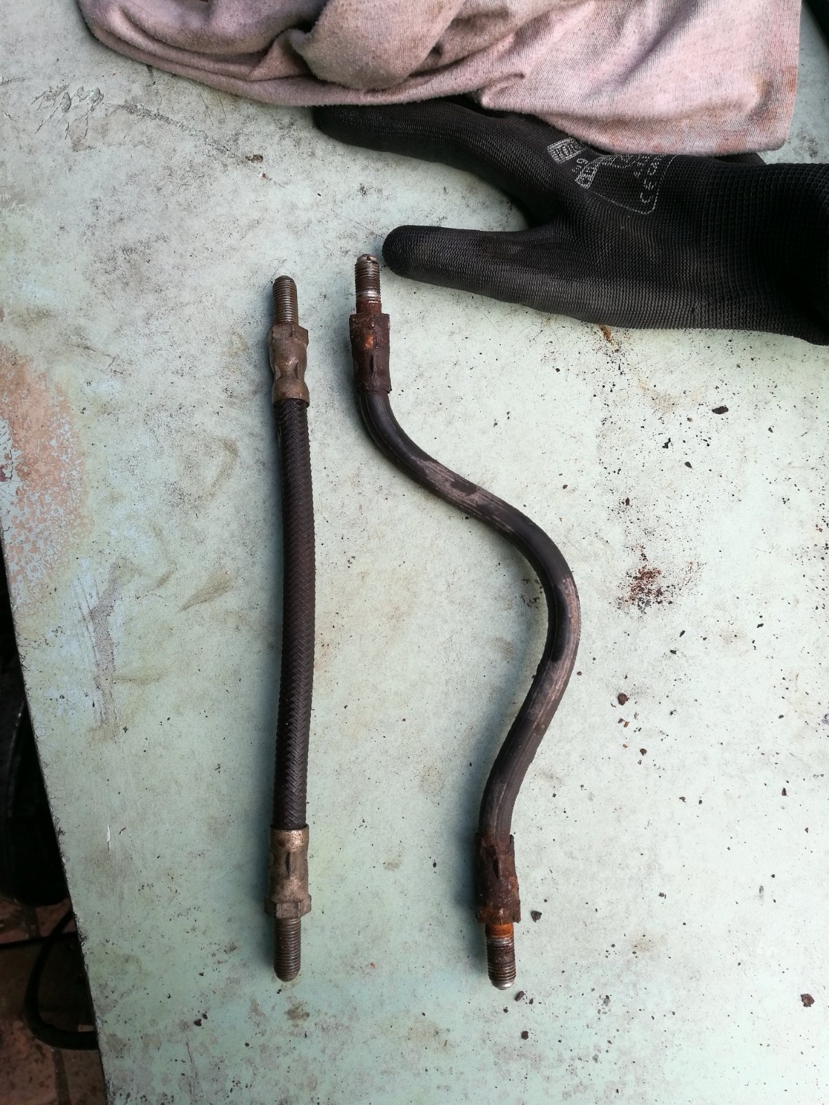

First up I went to change the rear brake flexis. Got the first one off no bother (access is just awkward enough on the inboard end to be "annoying" however not quite enough to be actually problematic). However sticking the new one in place immediately revealed a problem.
So apparently that pair of NOS hoses is for another invalid carriage...Most likely an Invacar Mk 12, and are too short. Annoying. I'll need to source another pair of flexis from somewhere then.
Figured as I'd already got the nearside half apart that I may as well change the line to the wheel cylinder - to find that someone has been in there before me, and has rounded off that fitting. Great! I've got a few spares, so once I have the right flexi hoses I'll cut the pipe off and just batter a slightly smaller socket on there to get it off. Given that I'm going to have to take it to bits again later anyway, I decided not to bother with it today though. Have drowned it in Plusgas as well.

Despite all of the grumbling though, I'm glad to report that I do now have brakes. Not faultless, but I do have brakes. I'm not sure whether there's actually an issue with the brake master cylinder I've got, or whether it's still just got a bit of air in. I seem to have an issue whereby if I depress the handlebar yoke very slowly, there's essentially no resistance and no braking effort. Doing it a little more quickly seems to bring a decent amount of braking effort, though the "dead zone" at the top of the travel does seem to vary a lot. Granted, I've not adjusted any of the drums yet either.
It means I have brakes though. I did lean on the handlebars with basically all my body weight and nothing went "pop" either, which is good to see. Having left the pedal under pressure overnight too, we've got nothing weeping from any wheel. I'll pull the jack out tomorrow and see if all three are actually providing braking effort. Offside rear definitely is (to the extent it has locked up when testing), and I seem to recall the nearside was before I had the first pipe blow out when I first changed the master cylinder.
