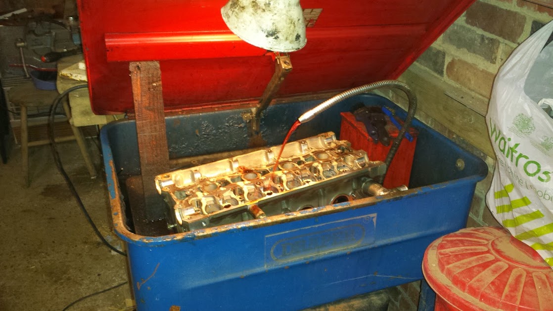

;) good old parts washer Jim .. arguably the most useful £30 I have ever spent second hand. (plus the Jizer)
