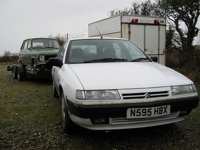

It was an early start today, for me at least, Mike (my co-pilot for the day) is far better at mornings than I am. Up at 8am, at the trailer place a smidge after 9am and then on our way to Wales. There was an horrendous jam on the M62 that added an extra hour onto our journey and was pretty tiring which meant more breaks than usual for us and for Blake-dog which meant even though we had set off at 9am we hadn't arrived until 4:30pm. We gather from the radio that there had been a broken down lorry shutting an adjacent three lane motorway down to just one and causing massive tailbacks as a result. The weather was reasonable, trailer was an absolute dream to tow and the weather was pretty good... right up until just after getting into Wales. It's traditional for it to be raining when I visit Wales.
Never really manifested into anything serious. We had to make a few more stops than usual as farty dog was with us, occasionally committing biological warfare on us. Satnav took us the correct way and apart from a minor hiccup when Mike put the car onto a soft verge, and promptly started to bog it down less than a mile from MrDuke's (the caretaker of the Renault for the past year or so) residence. Happily, I have some experience of unbogging cars and we were soon back on the single lane track and pulling in to see what I'd let myself in for.
MrDuke and Lady_MrDuke were perfect hosts, they come highly recommended, top people who even sorted some grub out for Mike and I on our arrival which was very generous. I don't think I can ever thank them enough for keeping hold of the Renault while my life fell to bits and was slowly glued back together over the course of the last year, there ought to be more people like that in the world.
By the time we'd nattered and procrastinated and let Blake run around the Duke gardens and generally make a pest of himself we thought it might be a good idea to load up the Renault. I have had a poke around the car and found it surprising in a number of ways... more on that at a later date. Sadly, because the light was failing my Spot The Difference picture didn't quite turn out as I'd hoped. It's close enough. First picture is of the caretaker's Xantia estate the day he collected the car, the second picture is my Xantia estate the day I collected the car.
It was then time to make the long trek home. The roads were a lot quieter, the weather not so bad and the Xantia was extremely competent. After the debacle Mike had with the 16' trailer he hired from another company we came to the conclusion he must have hired a pretty bad trailer. This one had working brakes and if it weren't for the Renault peering in through the back window all the way home you'd hardly know it was there. There was only one stop for fuel when I put £30 in the tank, I needn't have bothered, the Xantia would have done it on the tank of fuel in the car, still annoyed that I accidentally filled up with premium diesel but at least the cost is offset by the veg oil. You know what fuelling up means...
We carried on until we needed something to perk us up rather than Blake's chemical warfare. We stopped off at Wetherby for emergency coffee and emergency cabin venting.
Beautiful.
Then on to the unit where we offloaded the trophy. Amusingly, just as we were securing the trailer for the night Mike's brother appeared in a police van (Mike's brother is a police man) and we got a 'What is it' from the police officer with him and a 'that's HORRIBLE' from Mike's brother. Obviously that means it's an excellent purchase. It is the most comically bouncy car I've ever encountered too, suspension travel must be measured in metres and the seats are ridiculously softly sprung.
Once I've had a daylight poke around I'll provide a fuller update of the car itself. The round trip was 450 miles.
