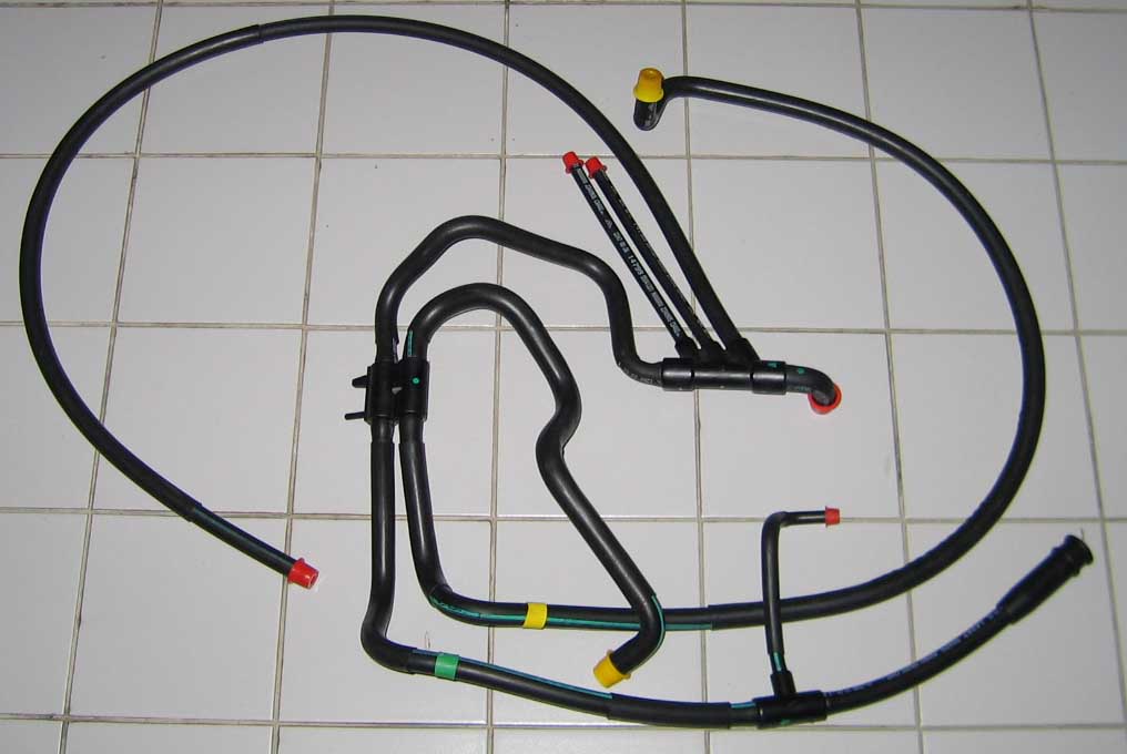

err- have to take a picture i think. Hard to explain. It comes out of the hydraulic reservoir then there is a kind of 3 or 4 way connector of which several tubes leave, one of which goes to the return on the pinion valve.. if i get the chance tomorrow i'll send you a pic

think this is it:
or part nº 2 in this diagram:

I know the one Larry, it's informally known as the octopus...
That one is going to be expensive whichever way you look at it and a complete ***** to swap too...
Depending on where it's gone you may be able to effect a repair by replacing the bad bit with a metal tube.
Where has it failed and how?
Edit: Your picure is the one.. See why it's called an octopus now can't you!

HI, in reply to Jim: The octupus failed at the pinion valve. I cut off the end with the split part and squezzed the tube back on- it's just long enough. However on examining it, most of the tube is cracked and probably only a matter of time until it fails again. I havent looked at the rest of it.
Not very encouraged that it may be so difficult to change though- i'll try to inspect it all when i get the chance and see if I could maybe do some kind of patching.
Otherwise, i'll buy one of those from citroenxm and wrestle with the octopus!
