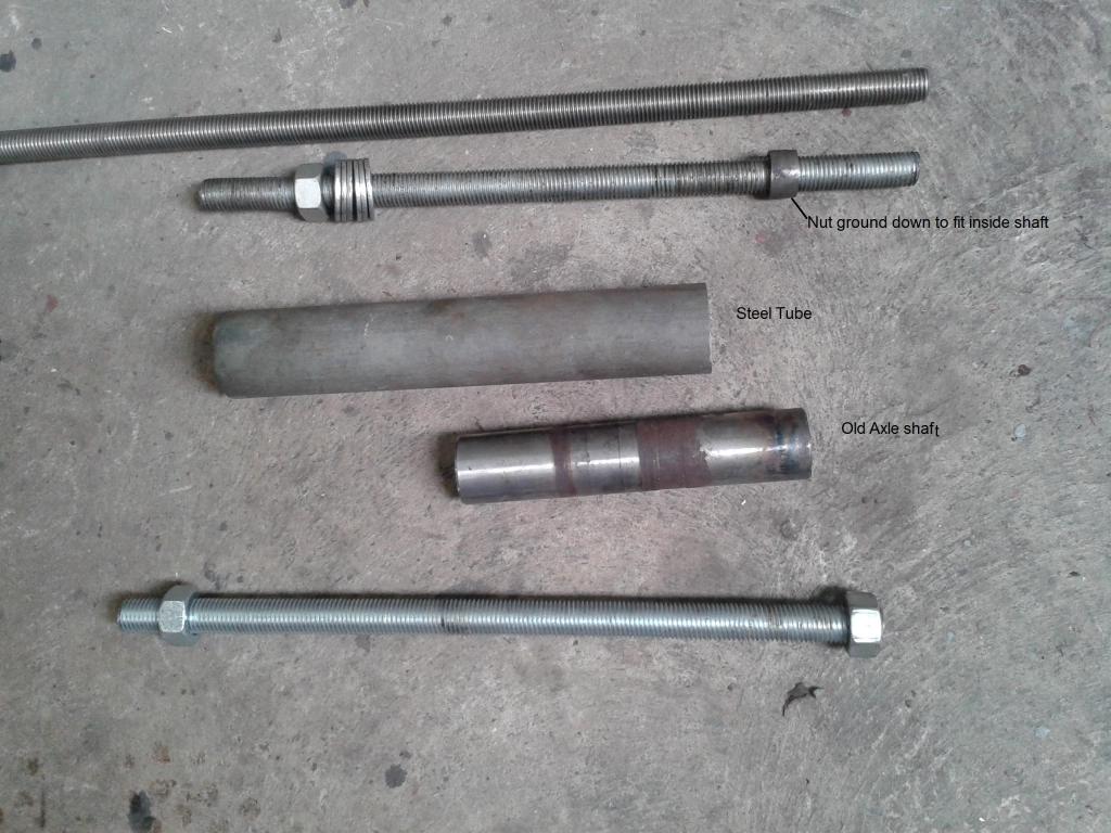

The 206 axle can be done in situ. To remove the shafts make a puller using a length of threaded bar. I used 25mm high tensile with standard thread. Pare down one nut so it will just fit inside the axle. A piece of 1inch domestic copper pipe can be used as a protector sleeve. Do not weld the nut into the shaft but deposit a ring of weld round the inside of the shaft. The same nut can be used to couple 2 pieces of bar together if you cannot get a long enough piece for reassembly. I could only get 1 metre lengths. Look at the video here it explains all http://www.ruville.com/en/all-about-us/ ... highlight/

See attached pic. Home brew kit on a budget. Yes it works. I just use washers. Molybdenum grease and more leverage rather than buy the thrust bearings as used on the Ruville tool.
I wouldn't recommend stainless steel. 8.8 or higher tensile is better. A lot of threaded bar is not rated at all. It is just a soft mild steel. Most engineering suppliers carry high tensile threaded bar.
