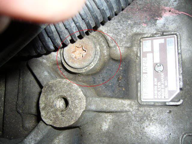

- Posts: 26424
Re: gearboxes
There should be an ID Plate near the filler hole on the top of the box
My advice if you do have an Aisin Warner TF-80SC, AF40/6 autobox, never drive through standing water, and change your ATF every 40-50,000 miles.
