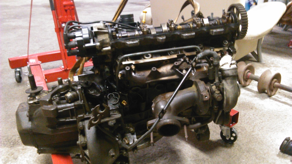

Mike, the pipe is now held by the turbo coolant pipes that run under and are clipped to the ally pipe.
They're a ***** to remove. If I recall they're one is help with 10mm nuts and the other bu 16mm stand-offs. Put a mirror under and all will become clear..

Mike, did you free both pipes both ends...
Don't forget you also need to undo the oil feed into the top of the turbo and disconnect the water inlet to the turbo before you can pull the ally pipe clear.
The oil feed pipe I think is 17mm and the water pipe has a rubber elbow that can be disconnected..
Keep going, you're within a scantling of getting the job done...

Maybe this could help a bit... TCT engine from behind. I'm afraid I don't have any pictures when everything was assembled...
Just remove the engine, everything is easy then!
