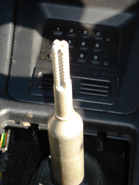

Warning very necessary: sitting in driver's seat, grasped knob with both hands and heaved upwards with face well clear. Waggled it slightly fore & aft while heaving even harder - and it suddenly shot off - nearly hit the roof lining!
For the benefit of anyone one else removing a Xantia gearknob, this is what the naked gearstick looks like
It pays to disconnect the gaiter first!
