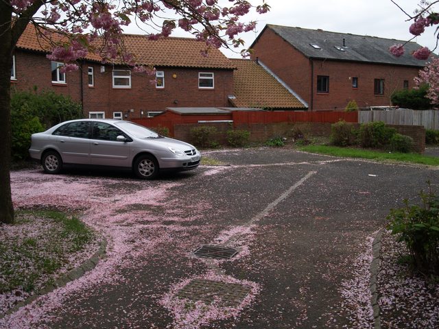

Onlinemyglaren
- Posts: 28712
- x 5672
Re: LHM change question
It is indeed Mike.
Blossom is practically gone now, house is full of it
That Aldi siphon pump is marked down to a fiver now (just been there).
The bit where my car is parked in the photo is pretty flat and the place I do my oil changes.
I'll get a sheet of cardboard from work in case of spillages. No-one will complain but it doesn't hurt to keep the place clean and tidy.
