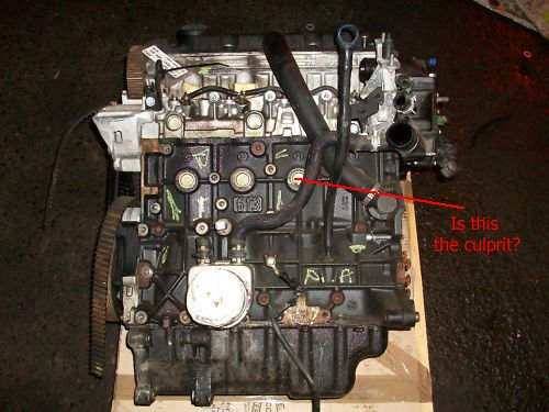

Xantia HDi coolant leak and a mounting list of problems.
Well I think it may be the beginning of the end for the old girl but I’m not quite ready to give up yet.
MOT due in 2 weeks time but the list of jobs is getting longer not shorter. Did an oil and filter change and then did the rear arm bearings last weekend not due to the Citroen lean but because of the knocks and the strange wear pattern on the rear tyre. This is the second time on a Xantia I have seen this tyre wear effect without any obvious wheel lean, on the BX the / \ effect was very pronounced.
Anyway, while I was doing rear arms she suddenly developed a bout of incontinence and stated leaking a significant amount of coolant while I was running the engine to get the suspension back up, and this on top of an LHM leak which is also on the list.
Further investigation this weekend seems to show that the coolant leak is somewhere around the area where the fuel filter bracket attaches to the engine. As far as I’m aware the fuel filter is not heated and looking at pictures of HDi engines (thank you ebay) the only place I can think it is coming from is the core plug – see below.

Re: Xantia HDi coolant leak and a mounting list of problems.
The filter houseing its self is NOT heated but the fuel is channeled up to the thermostat housing for fuel heating.
As for your Water Leak from the Core Plug I have a TOP TIP for this which DOES WORK! As Ive done it myself Rory..
Get some of this:
Its a sort of Epoxy Resin, and its PROPER TOP S H I T hot! And works brilliantly.
I had a customer last year with a big hole in a rear core plug on his HDi, I had some of this, tore a bit off, massaged it till it got warm from a chemical reaction, applied it to the hole, and it has NOT leaked again! VERY impressive! I keep some all the time now.
Get some of this:
Paul
Thanks for that tip. If it is the core plug then its not too bad a job and a new one is only £1.26. I've done one on this engine before five years ago but can't remember if it was one in the head or block, it was certainly easier to get to than this oneis going to be. If it was one of the others in the block then I've got a couple of spares somewhere because at the time a bought more then one as they were so cheap. But that stuff looks like the sort of think you should have in stock anyway, must have loads of uses.
Rory

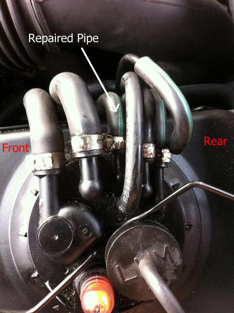

SORTED Xantia HDi coolant leak and a mounting list of proble
An update.
The sudden and large water leak turned out to be as anticipated the core plug behind the fuel filter bracket. Fortunately I had one (bought 3 when I needed one 5 years ago)
Rear cylinder boot swapped with one off a spare cylinder I had.
Finally found the hydraulic leak - not the steering supply pipe thank goodness but one of the plastic pipes going up to the reservoir. I'm assuming it is a return pipe but for what I don't know, does anyone have a picture of the reservoir with all the pipes identified for a Hyreactive Xantia?
Anyway, this pipe has obviouly been rubbing against the plastic pipe taking air from the air filter to the turbo and had finally rubbed through. Got one of the rubber connectors off an old reservoir, cut the plastic pipe, removed the damaged bit and joined using the rubber hose. 2 clips (from a triumph dolomite I scrapped 30 years ago, I knew they would come in sometime) to secure and job seems to be a good un. So all back together and working again, although, and I'm sure I'm getting paranoid, I'm sure there's now a knock from the off side when I turn the steering wheel, might be a track rod or track rod end. Now the distractions are out of the way I can finally get round to the pre MOT health check, if it is a track rod or end I won't be complaining, even a bottom ball joint wouldn't be too bad as I have a spare pair hubs so again just a swap over job.
Guess the old girl might be seeing 350,000 miles after all.
With any leak in the hydraulic return system, it's worth bearing in mind that all the returns join together at the manifold (the black snakes wedding) alongside the reservoir before the common return climbs over the top of the reservoir forming a the highest point (peak) of the system. The amount of LHM coming out of a return pipe leak bears no resemblance to the normal return flow in that pipe because any leak will be at a lower point in the return system than the peak, so LHM tends to flow out of a leak rather than be pushed over the summit.
Slowly making sense of this. The pipe I had to repair is No 3 from the front.
From this topic here http://www.frenchcarforum.co.uk/forum/v ... p?p=129536" onclick="window.open(this.href);return false; the pipes are identified as
1 - LHM take-up, ‘sucking’, to high pressure pump.
2 - Fluid return from pressure regulator, flow divider and front electrovalve (solenoid ?), from power steering and hydractive suspension.
3 - Return from steering ram.
4 - Return from height corrector, suspension cylinders, safety valve, pressure regulator and power steering.
5 - Return from height corrector.
6 - Return from brake doser, ‘hydraulic bloc’ and ABS.
7 - Return from steering valve in power steering.
8 - Venting of reservoir to atmosphere. (Also the overflow).
But from the diagramme I still can't quite work out which pipe is which. 1,2 6 & 7 are easy but the others are confusing. Of the remaining 4 pipes 2 have clips and the other 2 are just push fit so presumably aren't expected to see much pressure. My guess is the one I repair is either 4 or 5.
