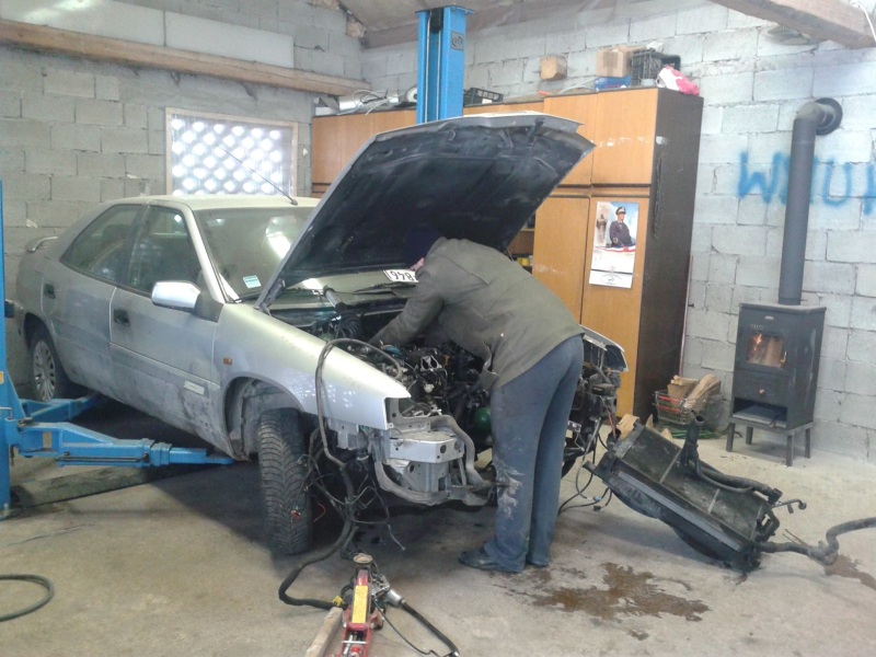

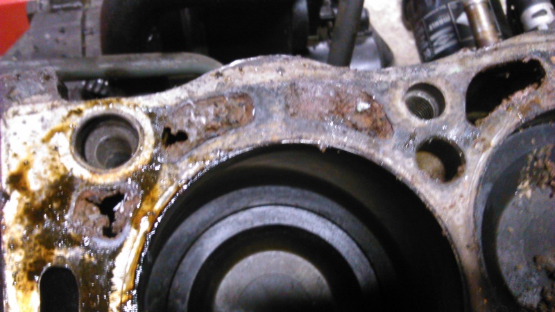

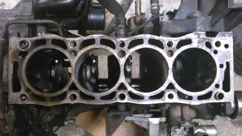

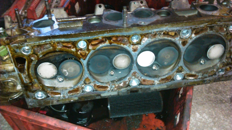

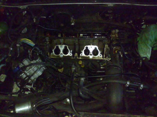

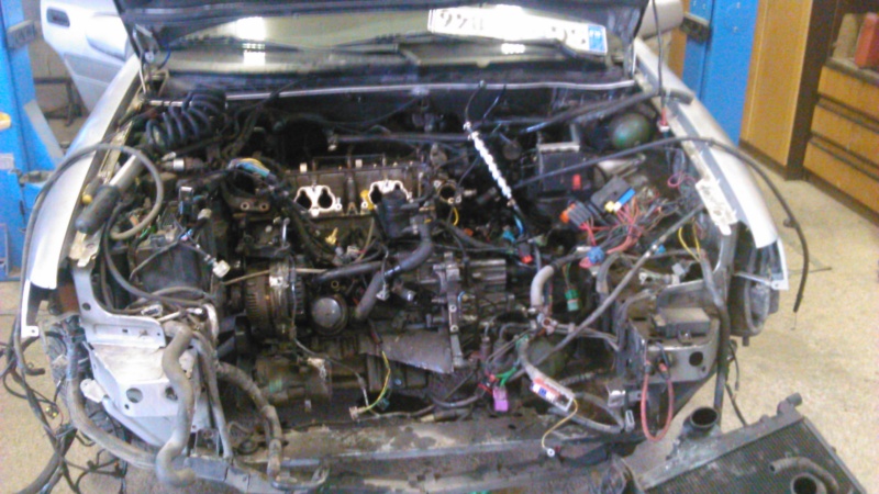

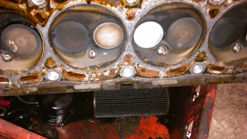

Well decided to remove the whole engine as the head is a PITA to remove. I managed to split the head from the engine block and I saw that the cooling channels are completely blocked. Have to clean them thoroughly and in the process I will also change the piston rings and check the turbo.
Anyone has some tricks that could help me removing the engine? And any other things I should do when the engine is out?
Here is how it looks now. Million things need to be disconnected... :roll:

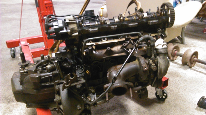

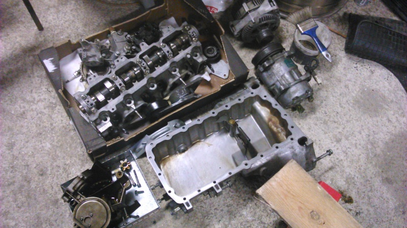

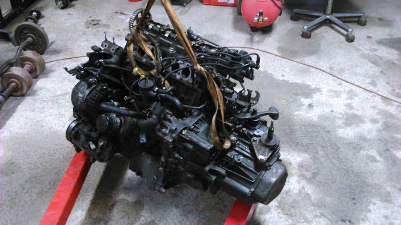

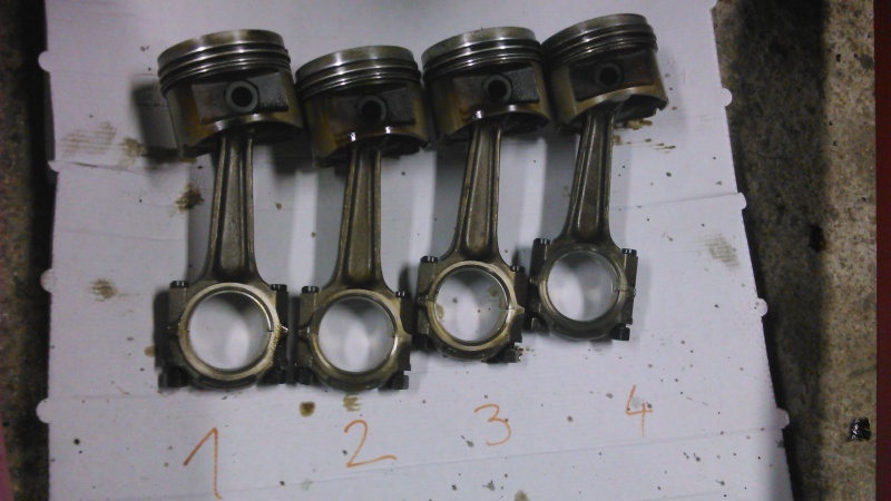

And I made it! I managed to remove the famous 2.0TCT engine. And now the party starts! Getting all back together will be a piece of cake... :rofl2:
Pictures tell more than words so here they are...

xantos wrote:And I made it! I managed to remove the famous 2.0TCT engine. And now the party starts! Getting all back together will be a piece of cake... :rofl2:
No they don't....Links broken :)
xantos
Posts: 409
Joined: 02 Apr 2013, 10:05
x 10
Re: Removing 2.0 TCT engine
Unread post by xantos »
Sorry. Repaired. Better?

They are quite blocked hey!
Any idea what caused them to clog up so much??
I seem to remember from some of the 205 drivers that with minor mods the tct can make good power gains, porting & polishing etc. Cam, With forged pistons you can clear 200brake with not too much bother!
I don't know why are they so blocked, but I have cleaned them so now they are free.
I am very much interested in power gain if you have some more information...

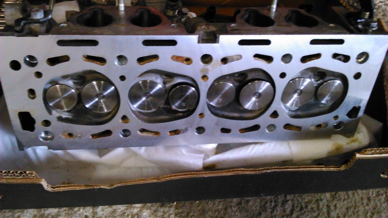

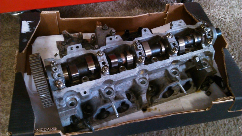

A bit of update.
Head grinded, valve seals changed, valve seats grinded.
Since I have the engine out decided to change the steering rack valves. As far as I know they tend to leak when you put hydrorincage into the system.
I ordered them at Citroen main dealer, price about 40eur, part.nr.: 4048.Q8. Hopefully I will never have a LHM leak again.

Today's work...
