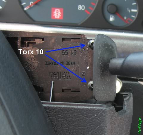

Stalk removal is easy. You need torx T20 and T10.
- Steering wheel cover is in two pieces and fixed with 3 screws (T20) from below.
- After removing screws, take off the upper half away.
- Steering wheel position so that the 2 stalks screws (T10) can be accessed easily (see pic).
- Disconnect the connector (pushing "nails" in and pulling off the connector) of the stalk.
- Connect the new stalk and test before putting all together again.

I read your signature but I was not careful enough and the stalk removal came for a Xantia
I have to edit my first message. Usually the current car is given in the first line and the sold/scrapped/gone car(s) added after that
It seems that (checking from ebay) Dispatch has either the conventional type of stalk or the new version COM2000 unit. If it is the newer version then it costs more and it needs more work to remove the unit.
