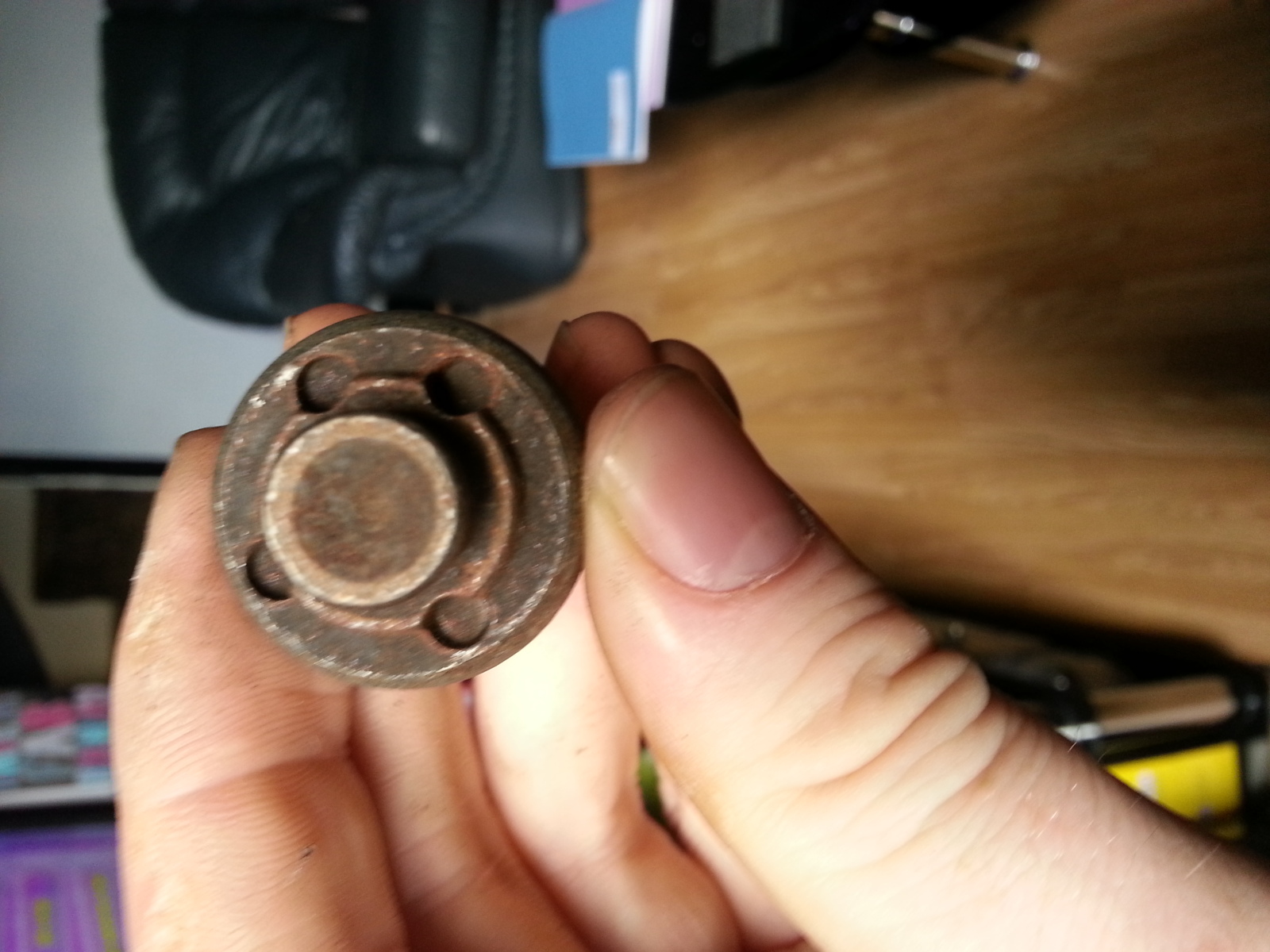

Hi all
Have a C5 Citrion 2001 model
How ever i dont have a wheel lock nut thingy to remove the lock nuts..
Citrion said they want 50 plus vat for it....
Case of wtf..
So does one know of a way to get these things removed....
This is one that i found in the spare tyre when i came to locate the nut thingy
so any help please
Case of wtf..
so any help please

Tyre depots have a kind of tapered spline socket that in conjunction with an impact wrench makes short work of them.

Yep, try a tyre depot, then replace the locking nuts with ordinary ones.
Sorry, but these day's nobody wants to nick a 12 year old car wheel.

or try the likes of these
https://www.google.co.uk/#q=locking+whe ... l&tbm=shop" onclick="window.open(this.href);return false;
the other option is two bricks
you just have to watch your thumbs

..or weld a nut onto it.

Tried all these things on my dear departed c5 with no joy. The outer bit of the bolt which guides the extractor on breaks off, leaving a worse problem. My only solution was a Good going electric drill, quite a few drill bits and lots of swear words. X4. These kind of lockers are the most despicable things I have ever seen, with maybe the exception of the ex wife. Drill them out, chuck them and replace. Much the same as wifes really

Are these nuts or studs?

Re: Need my nuts removing
Ah, OK. Wondered how Davie could drill out a nut.

When I had this problem I took it to my local tyre shop and they had them all off in less than ten minutes, not charged a penny, a special tool and a lump hammer did the trick.

they are bolts actuallyej2095 wrote:studs
but sounds like David has had experience of nuts also

I had 2 out of the four pins broken on the locking nut for my C5 X7 Tourer and I only found out when trying to remove the wheels for brake checking soon after purchase. My solution was to hacksaw 2 short pieces off the shank of a 4mm drill the same length of the remaining pins, jam them into the nut holes and use an impact driver to remove the locking nuts. It took a few blows on each nut but eventually they came out...
I have to confess I did purchase a new genuine set of locking nuts from my local dealership (where the car came from originally) at £50 but I made sure that they were well copaslipped before fitting and were done up with a torque wrench to the correct torque (force of habit after working in the automotive test environment!!). I will take these off before going anywhere near a tyre fitting bay...windy guns eat these type of locking nuts for breakfast, breaking pins and deforming the corresponding cutaways on the locking bolt (just like Discovery/Freelander ones used to )...

got 3 off... last one as always being a sod... BUT i go the one off i needed to as tyre was looking a tad dangerous
