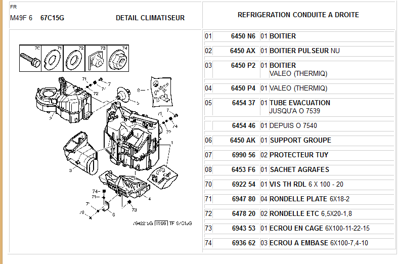

I want to know what the French call a heater box. Don't seem to get a lot of bites for "boitier chauffage".
It's stuck (fastened) somewhere near the TX valve area. Really need a borescope to see up the back of it - want to leave the evap hanging and slip the case halves off it for a scrub-up.

Boitier I think.
Checked by finding it on my Peugeot (near enough) parts data then finding it again with it defaulted to French. Note that its likely a different one though as there were several choices but at least you have the names now (1) and (2)
See pic:
EDIT... Let me know if you want a more detailed pic I did that in a hurry, should be able to get a decent size one in a bit if needed.
Andy.

I've been doing exactly the same (looking in French). :mrgreen:
I think actually, not many French can be arsed pulling the heater box out.
