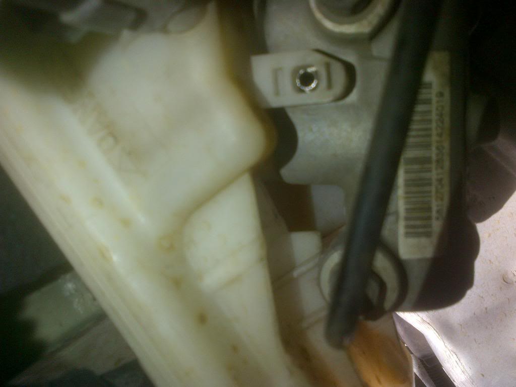

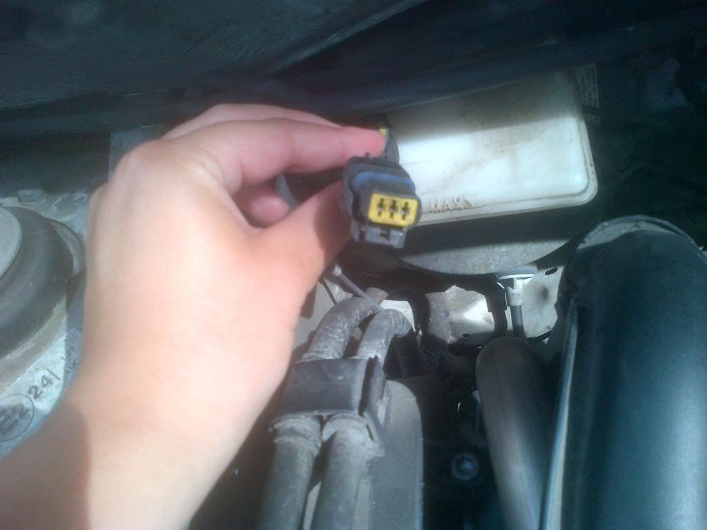

Nothing else obviously untoward but we have however noticed a vacant electrical connection over the fluid reservoir:
Should it be linked to this port on the Master Cylinder:
Thoughts?

i think the point you refer to in you picy is just out of shot

The connector (?) on the master cylinder is in the second shot. The circular centre pin socket is on the right side of the pic. There is certainly also a level sensor connector present and correct just below the 'danger' mark on the reservoir and that may well be out of shot.

That's not an alarm plug, or for heated washer nozzles?

The circular centre pin socket is not a socket at all but just a roll pin holding the tank to the master cylinder :shock: :wink:
