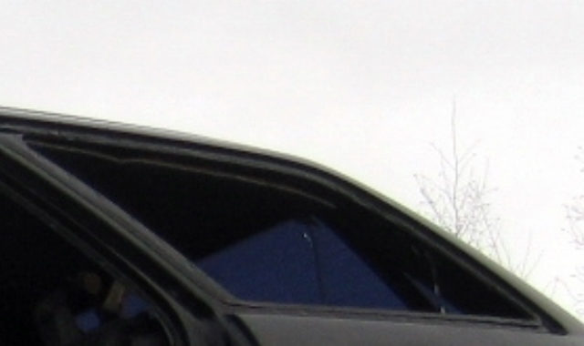

Long ago I have taken this pic in a scrapyard. I hope it gives some clue about how the window is fixed and helps you in planning the window removal job.
