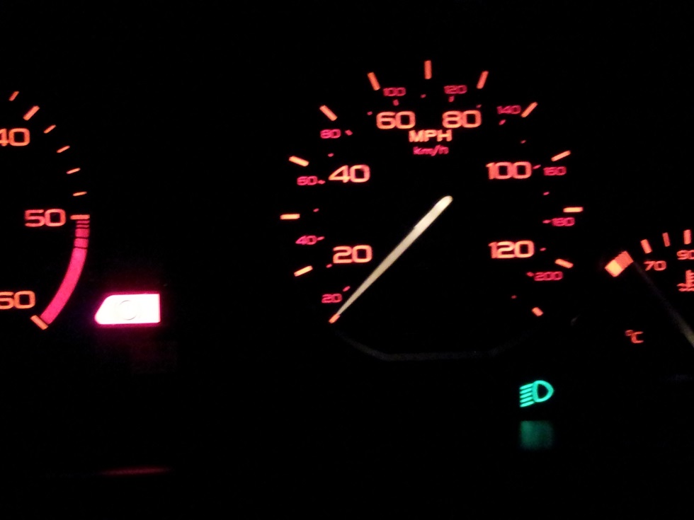

The second question i have is all of a sudden my mileage clock has totally dimmed, its barely visible in the day and non visible at night (please have a look at included picture)
im not sure if these are a lcd unit?? does anyone know? or is it as simple as replacing a bulb behind the lcd display, i think its an lcd display>? could have sworn i had a simlar issue years ago and peugeot confirmed it was lcd??
if it is an lcd display can it be fixed without having to change to a new lcd display??, as obviously itl be costly to put the milage back exact on the new lcd display, thats if it is lcd??
or again is it as simple as a bulb replacement?

I believe the display is illuminated by one or more bulbs in the rear, I expect these need replacing.

There's one bulb for the odometer display. Its actually slightly different to the rest of the illumination bulbs, in that its classed as a "long life" bulb although a normal one will fit I'm sure. The panel comes out quite easily once you've carefully prised the trim off with a suitable blunt tool.
