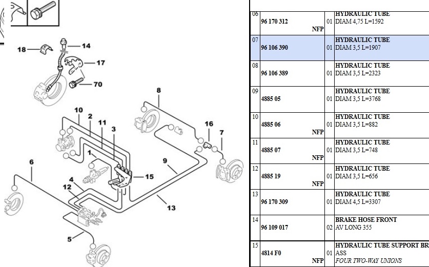

I have managed to get a log in for service citroen now and I have figured out how to post up pictures from it to the FCF, but I haven't as yet worked out which buttons Malcolm (citronut) and others press to get up the prices :) without going through the ordering/check-out procedures.

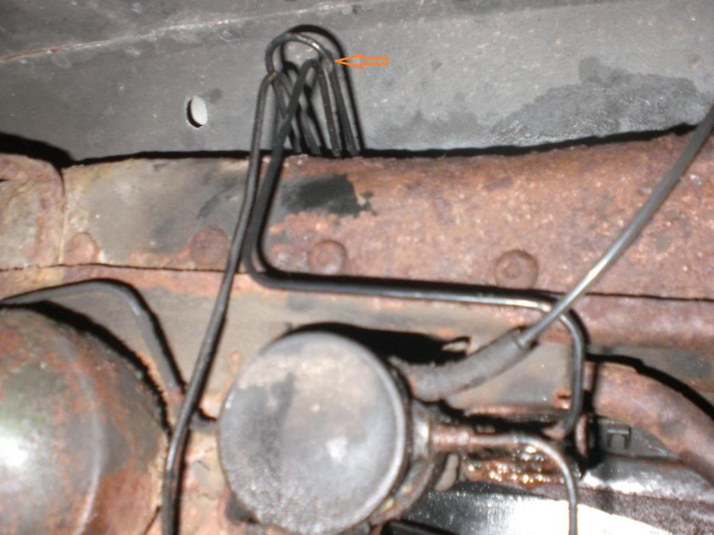

The red arrow shows the pipe I suspect the leak is from... the outside loop of the two........it goes down behind the subframe

Yea, I THINK thats the rear cylinder feed pipe.. it goes over to a K joint on the underside of the subframe..
Its a long pipe, which I make easyer now by having a Flare tool, so Im abe to cut out bad parts and put in new parts.
Now, this pipe is if original a single piece pipe and it does as you say run right to the front, up between the subframe and to the safty valve on the leg of the subframe, under the LHM tank. One of the 3.5 pipes goto one of the 4 pipes on the bulk head from the brake valve, but I think the one from the height corrector goes to there.

No. 9 on you drawing is the rear suspension feed not the brake feed,
No. 13 is the brake feed

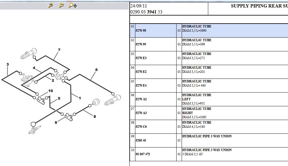

Which is exactley what neil has said.. its suspension feed thats leaking not brake..
Singular pipe from the rear K joint on the off side subframe behind the curly wirley brake pipe right round to the front saftey pressure valve...

Nah, No 9 IS the brake 'feed' - it's the one that comes from the rear height corrector to the brake valve. Thus, although it is brake related, it will leak all the time the engine is running as it is fed off the suspension.
I've not had the misfortune to replace a front-rear (yet) but I wouldn't use anything other than Kunifer - trying to get a steel pipe in there will be nigh on impossible. Routing it over the top of rear subframe will be difficult too - and you may need to drop the subframe or re-route the pipe to get it in. I would give Martin at Plaides a phone - he will a) make you up a (kunifer) pipe and send it out, and b) give some advice on replacing it :lol: KennyW replaced the pipe from the ABS block to the rear splitter recently - he might have a comment on it..... :roll:

The drawing at the start of the thread is what you get when you select braking/ then pipes/ RightHandDrive and with ABS Brakes and Without Hydractive Suspension for a Xantia 1.9TD 5 Door Saloon (correct for my VIN)
I cropped the picture without the titles but the section is headed Brake Piping
I presume all of the pipes with referenced numbers are "braking system" pipes.
I will try to clear it up with some definitive photography when the drizzle ends and the muddy pudddles on the unmade road drain away or evaporate :) I do suspect its the front-rear no9 pipe. I assume this is a braking system pipe.
Just for the sake of completeness. This is a picture of the rear suspension supply plumbing from service citroen. Somewhere between the two diagrams is my leaking pipe :) .......I intend to precisely identify it. One thing is for certain the leak comes down from a pipe behind the subframe towards the offside.
Looks like the front-back supply pipe is No 1 on this diagram. Its 3.69 metres long.
thanks Neil
