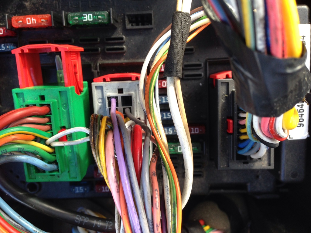

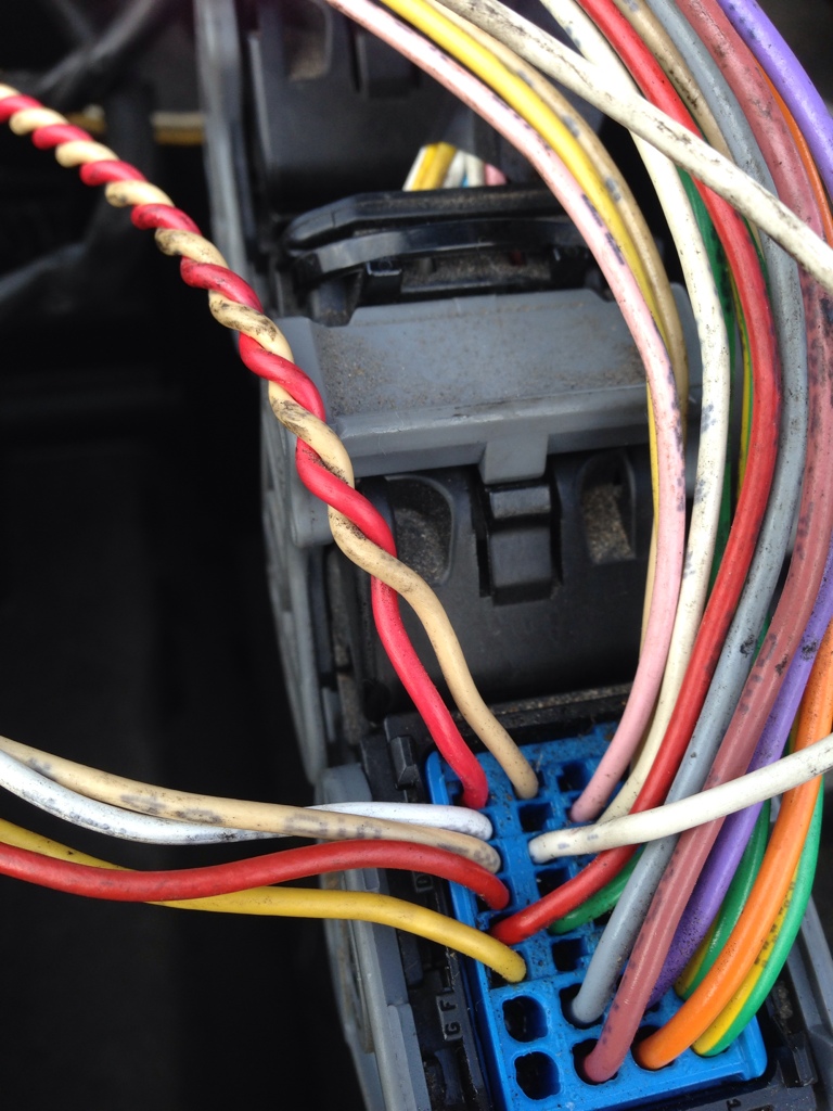

Lighty
- Posts: 1103
- Joined: 07 Jan 2012, 16:53
- x 34
Re: Wiring 406 coupe
Ok guys , the problem wire is CMO4F, the other no is a 1732, which refers to it being white I guess as its on the other white wire. The other one is 9006 which goes to the DLC connector & isn't used
CM04A appears to go straight from pin 12 of the 16 way green connector straight to pin C3 of the 32 way grey connector, try disconnecting it at both ends & see if it has continuity to earth.
As far as 1732 goes i cant find any reference to it on the injection system wiring diagram (from autodata). Where is this wire ? What component, connector colour & pin number ?
