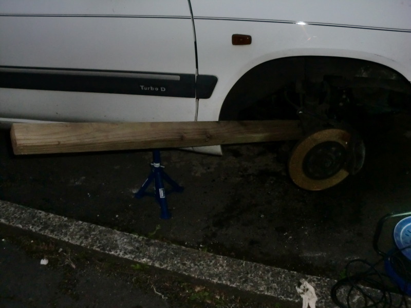

if what Jim says fails i use a long bar hooked under something solid at the sub frame end in such a way the bar also lays across the top of the swvel joint,
the bar needs to be long enough for you to sit on the outer end to add weight onto the swivel joint whilst undoing the nut

These jobs are so easy when you know how!
Many thanks for the tip citronut
Edit: I used the 3 x 2" timber by proping it behing the disc but made sure it was clear of the CV boot.

hope your not levering against the drive shaft
