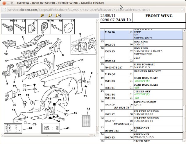

Hi, I have just changed the Auxcillary belt on my 1997 Xantia, While doing the job, I needed to remove the plastic gaurds to acess the belt. What type of bolts and fixings hold the gaurds to the car. Mine are totally coroded and unuseable. would these bolts and fixings be a dealership only product ( whatever they are called) thanks Terry . p.s. they have a 10 m/m head.

guys, i think he's refering to the wheel arch guards, 10mm bolts that go into those clip on nuts (captive nuts??) that Always rust and sieze in place!!

Yep, that sounds like it Timmo...Timmo wrote:guys, i think he's refering to the wheel arch guards, 10mm bolts that go into those clip on nuts (captive nuts??) that Always rust and sieze in place!!
I will have a butchers in Service.Citroen and see if I can find them...
Those shields are very important to protect the belt and pulleys from flying stones...

There we go...
Items 72 (Self Tap Screw) and Item 74 (Speed Nut) is what you need...
