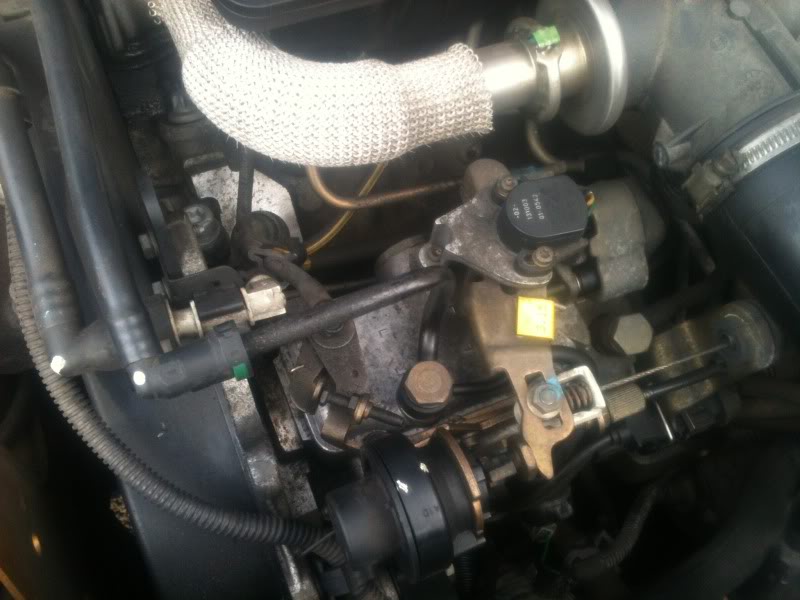

I have a Berlingo for my works vehicle. I have just noticed that there is a small amount of fuel leaking out of the top of the injector pump at the following location - which according to my manual is where the manual stop lever comes out of the top cover of the pump.
Now, the question is that it's obviously an o-ring inside the cover that has deteriorated. The question is, can it be repaired with the pump in situ with a replacement o-ring, or do I have to fork out for a new or reconditioned pump. If I could repair it in situ, any ideas as to where I could obtain the correct seal?

Basically, the job is easy. Remove the throttle lever, noting the alignment, remove the fuel return line and all other bits that obscures the cover, unscrew the top cover, carefully push down the throttle spindle (it stays attached to the governor spring) and renew the O rings on the throttle shaft and the big O ring under the lid. Merlin Diesel can supply spares but will need to know the exact pump model. Find it on the blue plate on the body. Replace the O rings on the cold start device shaft too whilst you're at it. Notre the alignment of the cold start cam (which remains in the lid) very carefully.
This is a very common problem on these Lucas pumps and more often than not a reseal will fix it. Very occasionally the throttle shaft boss in the lid will be found to be worn beyond use but this is rare.
The complication for you is the pump is armoured and generally the armour has to come off. This means having the pump off the engine. Once on the bench though the armour is not difficult.
You must work in the most spotlessly clean conditions you can and no dirt whatsoever must be allowed to enter the pump whilst the lid is off.

Re: Lucas/Delphi Injector Pump leak
The armour Andy, is hardened steel castings around the stop solenoid and immobiliser module to prevent tampering. The armour castings are normally held on with anti-tamper bolts that need a reverse flute socket to undo or perhaps other ways. This armour normally hinders removing the lid.
I've no pictures of the Lucas armour but the pictures here of a Bosch pump show the armouring and how to remove it. For a Lucas a more or less similar approach is needed although different in detail.
If you can see the entire lid and its four screws then you won't need to de-armour. One type of Lucas armour goes right around the back of the pump (to hide the immobiliser electronics) and the armour is craftily interlocked which means all parts have to be removed like a puzzle piece. They thought about it!
Removing a pump is not that hard but sadly, in the case of your DW8 engine the cambelt has to come off too so I can understand why you're keen no to. The earlier XUD engines allowed the pump to come off without disturbing the cambelt by being able to leave the drive sprocket in-situ. This wonderful facility was deleted in the later DW8.
Take some much more detailed pictures if you wish and we can advise further... I can't see the armour in the picture you have posted.

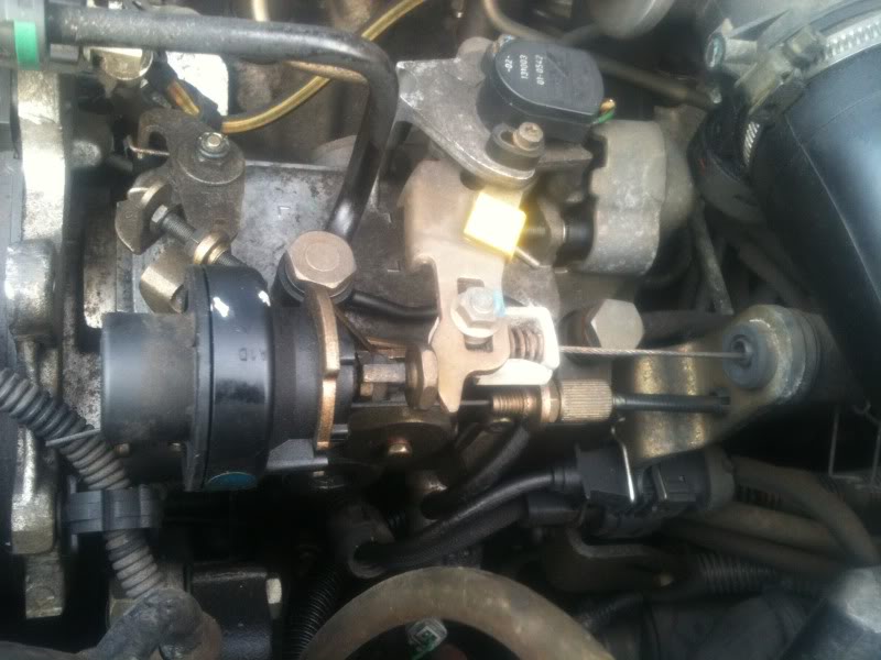

Here are some more photos

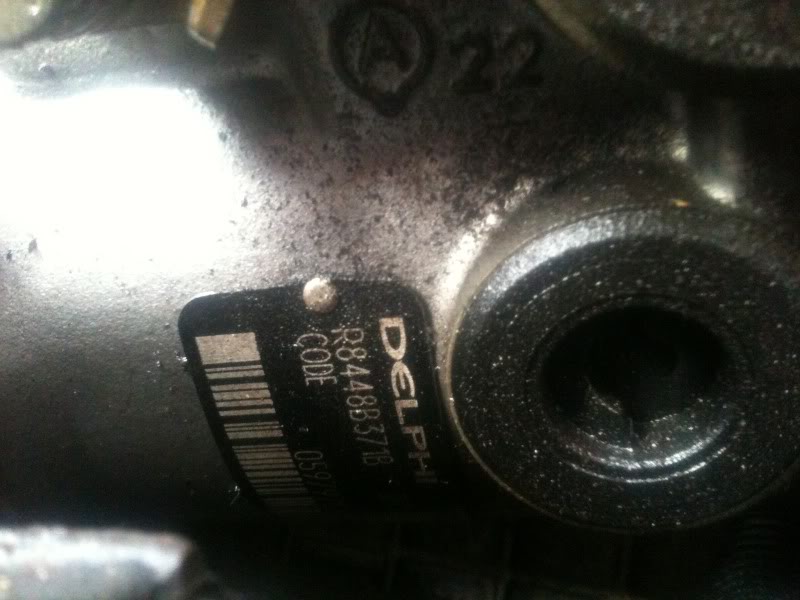

And I take it this is the part number I will need to quote?

To me, it doesn't look armoured?

It is!!! See the metal shielding near the load pot on top of the throttle shaft and adjacent to the fuel inlet banjo. That's the armour.
However, looking at the pictures I reckon there's a good chance, so long as you can remove the load pot and all the other stuff around the lid, that it will come off without de-armouring. The only slight impediment might be were the end of the throttle stop screw tucks in under the armour but hopefully it will just wriggle out. VERY careful use of a Dremel or similar may enable you to trim back the armour here to give clearance.
It has to be worth a try anyway...
You have the pump code there nicely on the plate :-D The number needed is the one that begins R844..
