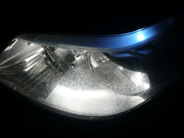

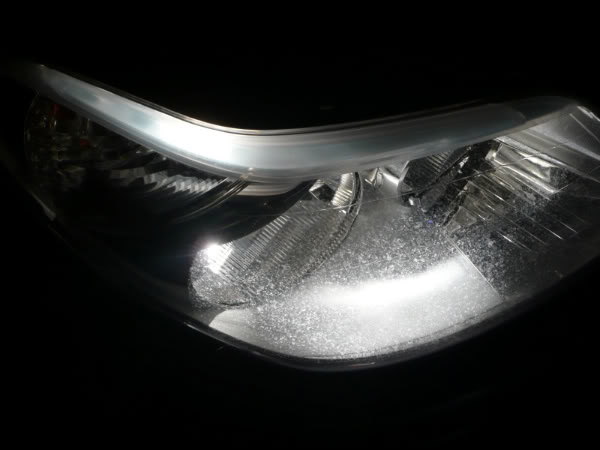

Do they give a pure white light?JohnD wrote:Alec B wrote: Which LEDs did you get? .
These:- http://www.amazon.co.uk/gp/product/B004 ... 00TA4923YW" onclick="window.open(this.href);return false;
I got some but they were more blue and illuminated less of the sidelight shape, so I took them back out.
LED:
Normal:
Both:
