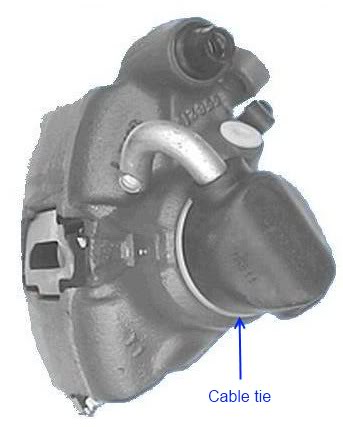

VertVega
- Posts: 1178
- Joined: 01 Nov 2008, 19:39
- x 13
Re: Xantia hand brake issue
Did you check the condition and amount of the grease under the big black rubber protector cap?aerodynamica wrote:... Now the thing is freed off but the spring has lost its tension. ...
It is fixed with a cable tier. Cut the cable tier and lift up the cap. Clean the remaining grease.
There might be some rust if water or humidity has gone through. The spring will be seen
and check the condition of it. It should move easily by moving the lever by hand.
After cleaning, fill with new grease.
Edit: and a pic where the rubber cap is seen.
