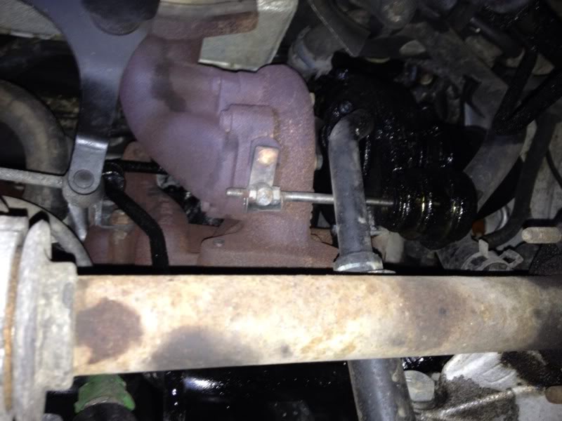

Hi,
Just half way through a clutch change on my Mk1 Xantia SD and as I was getting it propped up I noticed this on the exhaust manifold. What is it?

Clutch? Its on the exhaust manifold! I was guessing that it was some sort of valve to divert hot air to the inlet etc. it's where I imagine the turbo would be if it had one. Just thought it looked complex for a diverter valve. Sink? When I leave mine overnight the back end just sinks maybe a couple of inches that's all. Does that make it an anti sink?

Looks like an ordinary wastegate on a turbo engine, to me?

addo wrote:Looks like an ordinary wastegate on a turbo engine, to me?
Excactly, it's the wastegate and wastegate vacuum actuator...
It's oily which suggests one or other of the inlet pipes is a bit loose/leaky and may be leaking off a bit of boost... Else thet, check the pressure lubrication feed and return pipes to the turbo for leaks.

Hmm. My point being however that this is an SD. I thought the SD was non turbo?

Allante666 wrote:Hmm. My point being however that this is an SD. I thought the SD was non turbo?
Later SD's had a low pressure turbo.

It just doesn't ave an intercooler like turbo d engines. It has the turbo though clearly
