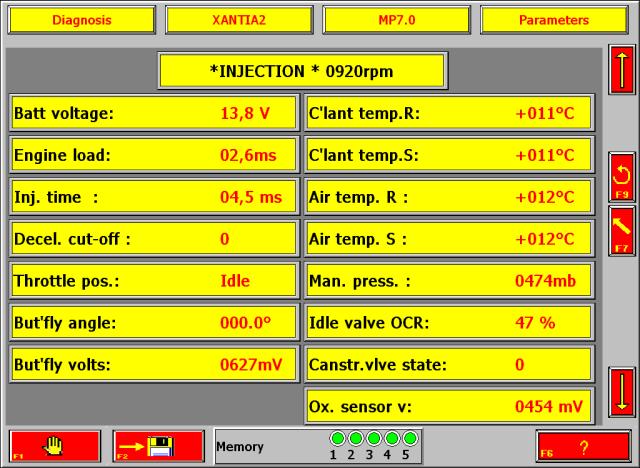

Hi Paul, this is my V6 cold and just after startup..
Injection Information:

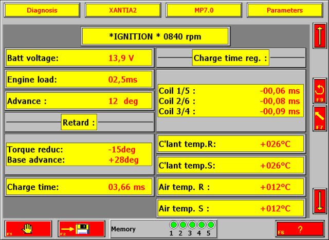

Ignition information

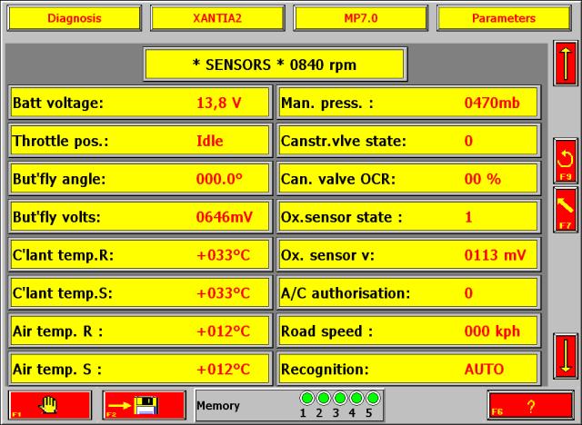

Sensors:

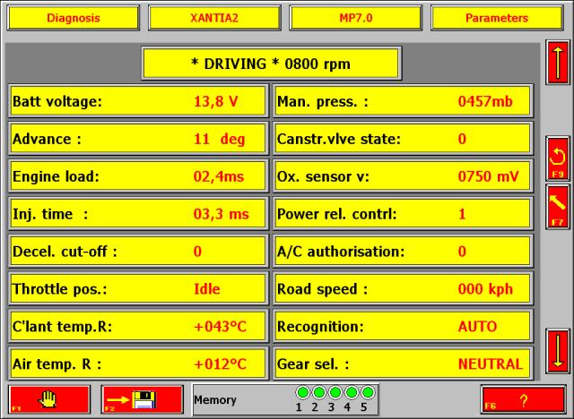

And finally, driving parameters although the car was not moving at the time...
'Fraid the engine warmed a bit whilst this was going on.
Don't forget that even from just off ciold the Oxygen Sensor will be cyclically varying between about 100mV and 850mV.
Hope that helps...
