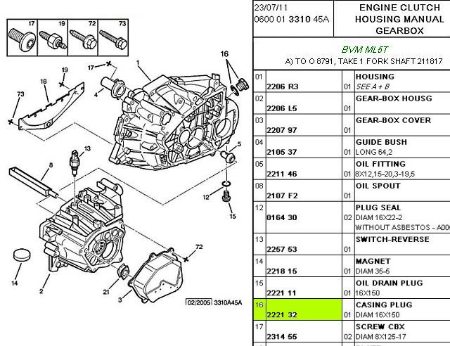

I'm pretty sure that pic is wrong VV - service.citroen just shows that as on ordinary bolt with no seal behind it - whereas there is 'Casing plug' (with seal) on the back of the diff - it's probably the one shown sticking out with a bigger head just up and right from the drain plug you have highlighted red. Which is is why it's impossible to get at with the 'box in the car :roll:

RichardW wrote:I'm pretty sure that pic is wrong VV - service.Citroën just shows that as on ordinary bolt with no seal behind it - whereas there is 'Casing plug' (with seal) on the back of the diff - it's probably the one shown sticking out with a bigger head just up and right from the drain plug you have highlighted red. Which is is why it's impossible to get at with the 'box in the car :roll:
Thanks RichardW, updated the above message and adding this pic. below.
I hope 411514 will also notice this message :oops:
So it's the #16.

Yeah cheers vv & gibbo, iv spotted it, looks like maybe il just have to fill with the specified 2.1 litres, that level plug looks pretty inaccesible, cheers sam
